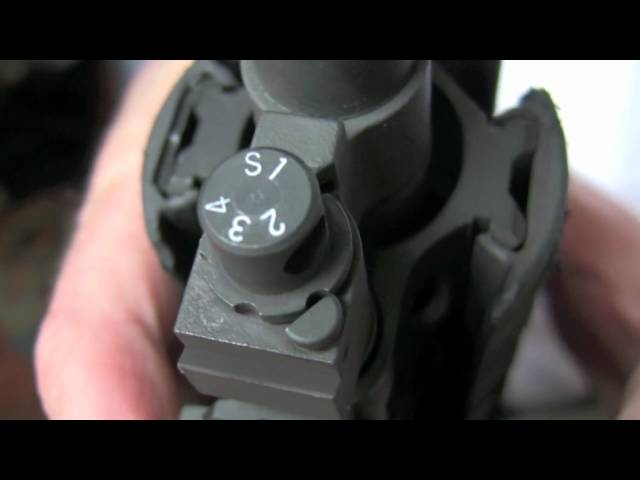

I think the old trigger was known for having trigger slap.
Trigger slap at level 4 on the gas valve was normal and due to high pressure level (See operator's manual - it's written there also).
Rotating gas valve on the gas block and lowering to level 1 or 2 was good enough for daily shooting and no trigger slap.
Level 3 or 4 was for break-in period with hot loads like Federal American Eagle.
And for the 7.62x39 users out there... Have a look at that video:
