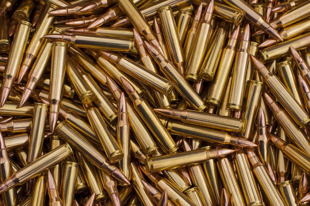

Can you tell which of these rounds are .223 and which are 5.56? Because .223 Rem and 5.56 NATO share the same external dimensions, it can be hard to tell the difference. Because SAAMI specifies that pressures must be measured one way and the military specifies that they must be measured a different way, a direct comparison of pressure results from one lot of 5.56 ammo (measured the US Military way) with another lot of .223 ammo (measure the SAAMI way) is not possible. It’s required to test both with the same methods, instrumentation, and chamber to see any real differences.

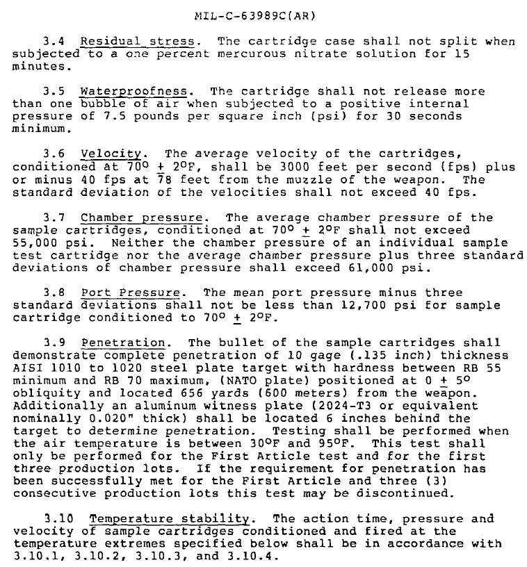

Theoretically, any manufacturer could make ammunition which exceeded the maximum pressure specified by SAAMI for the .223 cartridge and call it 5.56. That pressure could be exceeded by 1% or 10% – it really wouldn’t matter. It’s the functional equivalent of “+P+” ammunition – there are no official guidelines for it which ammunition manufacturers have agreed to follow, as is the case with SAAMI. You could almost consider it to be the world’s most popular wildcat cartridge, as far as SAAMI standards are concerned.
Despite this lack of SAAMI standardization, most of the 5.56 ammunition on the market is manufactured by companies that produce 5.56 for various militaries; the 5.56 they sell to civilians is essentially identical, and thus follows the requirements and maximum pressures set forth by those military clients. As you can see from this short excerpt from a 27-page specification for US Military ammunition, military requirements are very exacting.
Military requirements for ammunition are quite stringent. But those military clients are purchasing ammunition for military rifles, which brings me to the next difference between the two: chamber dimensions.
Summary: While .223 Remington chamber dimensions and maximum pressures have been standardized by SAAMI, 5.56mm NATO dimensions and pressures have not. Partially because of this, ammunition pressures are measured differently between the two, and cannot be easily compared. Still, it is generally agreed upon that 5.56mm ammunition may be loaded to higher pressures.

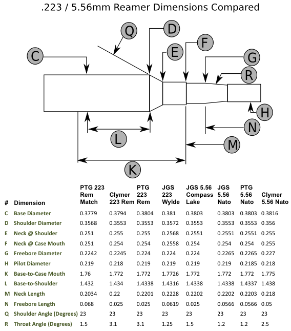

.223 Remington ammunition is pressure tested in what is called a “SAAMI Minimum Spec” chamber – that is, a “worst case scenario” chamber in this regard, made to the smallest dimensions, which would result in the highest pressures with any given ammunition. In reality, the likelihood of encountering such a chamber outside a testing lab is incredibly small. Many .223 Remington chambers will see maximum chamber pressures which are several thousand pounds per square inch (PSI) lower than those seen in SAAMI test barrels.
These SAAMI specifications for .223 Remington chamber dimensions allow for a range of minor differences between manufacturers. At the other end of the spectrum are 5.56mm NATO chambers, which will exhibit lower pressures than .223 Remington chambers with the same ammo. Sometimes, even 5.56mm dimensions are exceeded. These “5.56mm Plus” chambers are sometimes reamed (machined) intentionally to provide the most insurance against excess pressures, but other times they’re just the result of careless machinists.
In between are chambers designed to balance pressure and accuracy, for the long freebore and throat dimensions of 5.56 NATO chambers are often blamed for reduced accuracy in comparison to .223 Remington chambers. These include .223 Wylde and 5.56mm Noveske Match Mod 0. Even among these, there are differences in reamers – one company’s idea of .223 Rem is not the same as the next. Take a look at this comparison chart and you’ll see a dizzying array of differences.
This chart shows a wide variety of differences between each reamer company’s idea of .223 or 5.56 chambers – and it doesn’t show all of the variations on the market (data courtesy of AR15Barrels.com). What all of these chambers have in common (with the exception of the Noveske chamber, which is produced by only one shop) is that they are reamed by a wide variety of machine shops and personnel who may or may not be experienced, skilled, or caring. When you buy, for example, a .223 Remington rifle, you’re probably not getting a chamber that’s identical to the others on the shelf.

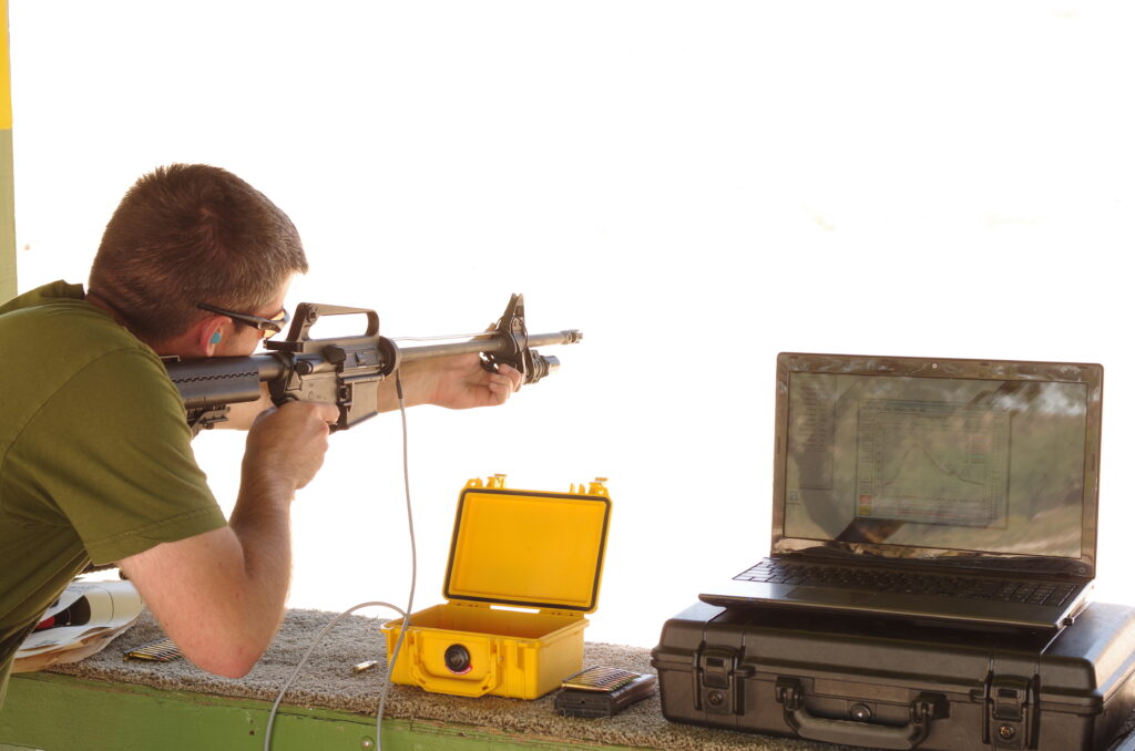

How I Tested Maximum Average Pressures
In order to test how 5.56 and .223 ammunition behaved in different chambers, I used a .223 Remington bolt action rifle and two 5.56mm AR-15 rifles, strain gauges, and pressure monitoring equipment. All gauges were attached at the midpoint of the case, which is where SAAMI tests pressures; military/NATO pressures are measured at the case mouth. All three barrels were 20″ in length. The Weatherby Vanguard Compact .223 Remington barrel had a twist rate of 1/12 and was not chrome lined; the FN 5.56 barrels were 1/7 twist and chrome lined.
Federal XM855 ammunition and FN 20″ 5.56mm AR platform rifles were some of the ammunition and firearms tested. Because I’ve just finished explaining how there can be a wide variety of dimensions for a given chamber, it should be fairly obvious that a small sample size of chambers for pressure testing cannot possibly represent every possible combination on the market. However, I felt that it was better to test a large amount of ammunition in a few rifles than only a few rounds in a large amount of rifles (the results were still quite educational).

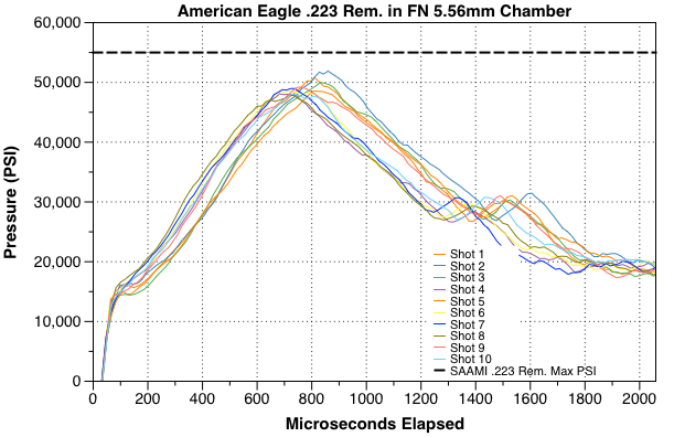

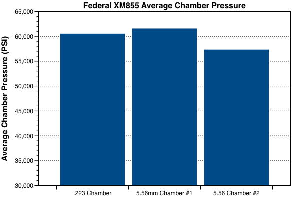

As pressure curves for production ammo go, these ten shots of Federal 5.56 ammo in an FNH-USA 5.56MM chamber were relatively consistent. <img src="http://www.luckygunner.com/labs/wp-content/uploads/2012/06/Replacement-5.56mm-NATO-.png" alt="Photo of M885 Clean Bore A41"/><p style="text-align:center"><a href="http://www.luckygunner.com/labs/5-56-vs-223" title="Read about 5.56 vs .223 ammunition on Luckygunner.com">Read more about 5.56 vs .223</a></p>

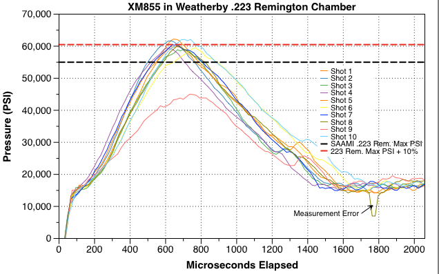

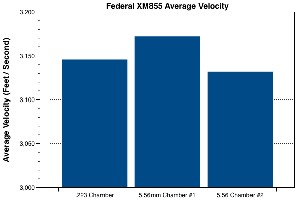

The observed chamber pressure for Federal XM855 5.56mm ammunition in a .223 Rem chamber exceeded .223 maximum pressures, but not by a massive amount. The ninth shot (the red line separate from the others) was an underpowered cartridge which exhibited significantly lower velocity and pressure than the other rounds, so it was excluded from the average velocity and pressure numbers for this chamber, because it would unnecessarily skew them too low. <img src="http://www.luckygunner.com/labs/wp-content/uploads/2012/06/pressure4.png" alt="Photo of Pressure"/><p style="text-align:center"><a href="http://www.luckygunner.com/labs/5-56-vs-223" title="Read about 5.56 vs .223 ammunition on Luckygunner.com">Read more about 5.56 vs .223</a></p>

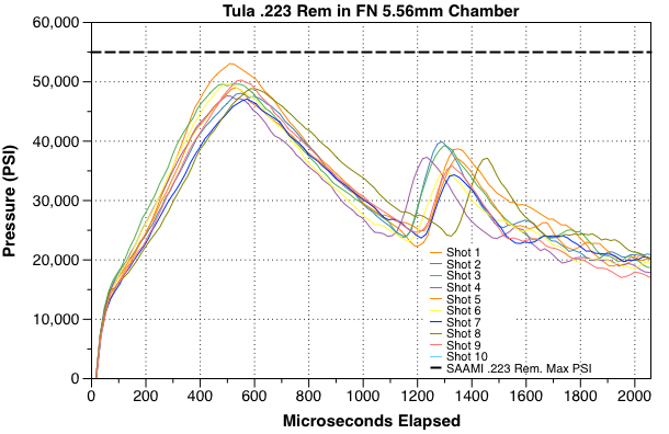

Federal AE223 was loaded consistently and offered significantly lower pressures in 5.56mm chambers, while still cycling the actions of mil-spec AR platform weapons. <img src="http://www.luckygunner.com/labs/wp-content/uploads/2012/06/ae223.png" alt="Photo of Federal AE223"/><p style="text-align:center"><a href="http://www.luckygunner.com/labs/5-56-vs-223" title="Read about 5.56 vs .223 ammunition on Luckygunner.com">Read more about 5.56 vs .223</a></p>

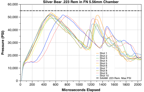

The secondary pressure spikes seen in this graph may be discussed in a future article on LuckyGunner Labs. <img src="http://www.luckygunner.com/labs/wp-content/uploads/2012/06/tula-223.png" alt="Photo of Tula 223"/><p style="text-align:center"><a href="http://www.luckygunner.com/labs/5-56-vs-223" title="Read about 5.56 vs .223 ammunition on Luckygunner.com">Read more about 5.56 vs .223</a></p>
The secondary pressure spikes and ignition delays seen in this graph may be discussed in a future article on LuckyGunner Labs. <img src="http://www.luckygunner.com/labs/wp-content/uploads/2012/06/silverbear-223.png" alt="Photo of Silverbear 223"/><p style="text-align:center"><a href="http://www.luckygunner.com/labs/5-56-vs-223" title="Read about 5.56 vs .223 ammunition on Luckygunner.com">Read more about 5.56 vs .223</a></p> Because of their consistency, and because .223 Rem pressures should be at least more similar from barrel to barrel than 5.56 pressures, Hornady .223 Remington ammunition was used as a “calibration load” for the pressure monitoring equipment. In essence, it is required to use a load of known pressure to calibrate the equipment and provide a useful comparison with any other type of ammunition or chamber.

Strain gauges and a PressureTrace II system were used to collect the data shown in this article. In order to ensure that I was getting the most accurate maximum average pressures possible, I contacted the manufacturers of a number of different types of ammunition with the results I had found. Of the manufacturers that responded, none informed me that my maximum pressure results were inaccurate (although they were understandably reluctant to disclose their proprietary data).

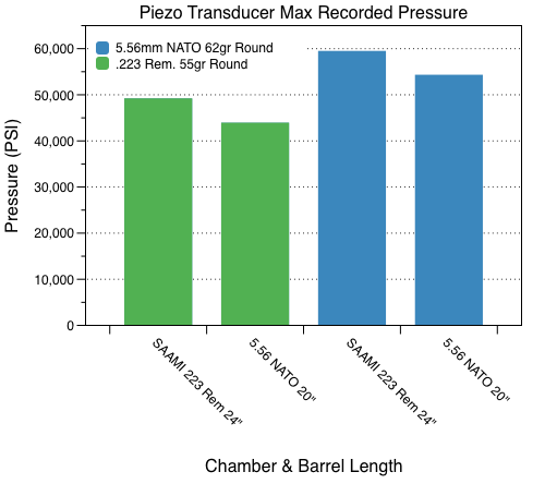

I know most people are interested in this part – and yes, I really did fire 5.56 in a .223 chamber. I had a friend at the range with me at the time, and he stayed a good ways back when I did so. I was not concerned about what would happen, and as I expected, the results were not spectacular.
However, I was surprised about the results I saw. There was no dangerous spike in pressure from firing 5.56mm ammo in a .223 chamber. While pressures were elevated in comparison to one of the 5.56mm barrels, they were slightly below the other 5.56mm barrel.

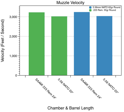

This unexpected difference was also borne out by chronograph measurements, which showed that the Weatherby Vanguard Compact bolt action rifle fired the XM855 ammunition (all of which was from the same lot) at a velocity which was higher than the lower pressure 5.56 barrel, but lower than the higher pressure 5.56 barrel. It’s true that the .223 barrel showed about 5% more pressure for less than 1% more velocity than the lower-pressure/lower-velocity 5.56 barrel, but the difference was not astoundingly large, as some might have expected.
In fact, the higher pressure 5.56 barrel – which was in the same condition as and made on the same production line by the same manufacturer as the lower pressure 5.56 barrel – was putting out XM855 at an average velocity within spitting distance of 3200 feet per second. As my gunsmith friend has told me several times, velocity is a sign of pressure, and this second 5.56 barrel showed both increased velocity and increased pressure compared to the other two.

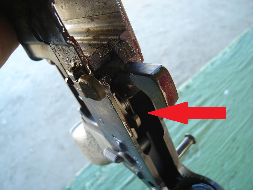

Although my results are still anecdotal, I do not recall seeing anything worse than popped primers from firing 5.56 in a .223 chamber (or 5.56 in a poorly machined “5.56 chamber” that isn’t really a 5.56 chamber). It’s important to note that most of the .223 chambers I’ve fired 5.56 in didn’t show any signs of excess pressure, although I didn’t chronograph each and every one.
If a popped primer lands inside a fire control group (where the red arrow is pointing), it could cause the weapon to stop functioning.
Popped primers are definitely a sign of excess pressure or an abnormal pressure curve, and should not be ignored. They can become wedged in some of the more important bits of an automatic rifle, causing it to stop functioning, and while this could be annoying at the range, it could also be fatal in a self-defense situation.

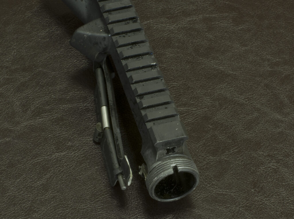

This AR-15 upper receiver was destroyed due to extreme overpressure, but this was not the result of firing 5.56 in a .223 chamber. While I do not wish to put words in their mouths, none expressed great concern that I would have a rifle blow up in my face during the course of my experiments. In fact, most said that the actual differences are, in effect, “not a big deal.”
