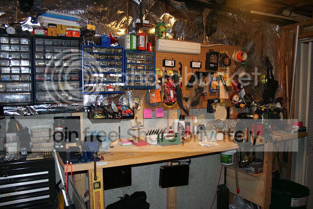

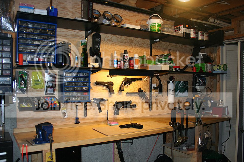

I ripped out my old workbench and made one a fair bit taller so that it's easier to work on firearms (easier on my eyes at least!). I still want to be able to have enough room for repairs and mods after all this is set up (plus vice, grinder/buffer). So I'm not looking for a huge operation, just one I can spend an afternoon and end up with a nice pile of ammunition for the next week's journey to the range :)
