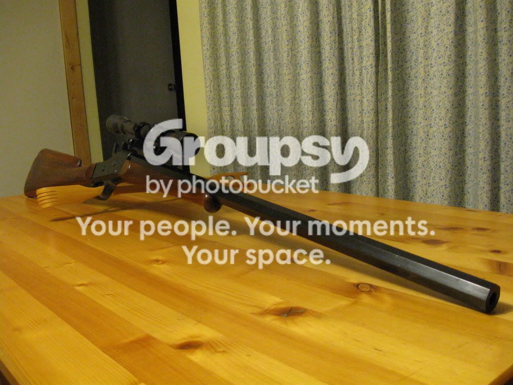

I have an Argentinian contract RRB that I did a sportsterised job on. It was a great original condition full military rifle in 43 Spanish when I got it. One day I noticed what appeared to be a hair stuck to the bore but I could not shift it, it turned out to be a crack in the barrel so I sold the wood and made it into the rifle I wanted, it's now a 45/70. It loves 500 grn home cast bullets, with anything lighter the accuracy suffers. The scope is an old Kollmorgen bear cub.
