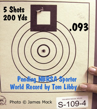

Bechrest is kind of addicting if the possibility of shooting like this interests you. Takes a lot of practice though.

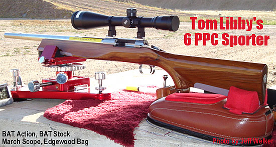

And here's the gun it was shot with.
Wow. I thought BR was all precision, no need for accuracy. That does both right in spades.
What is the process for verifying that the 5th is on paper BTW?
Good point. We use what is called a moving backer. Basically its a roll of paper behind the target that moves slowly. Driven by something like a BBQ rotisserie.
So its easy to tell if five shots were taken or less or more.
