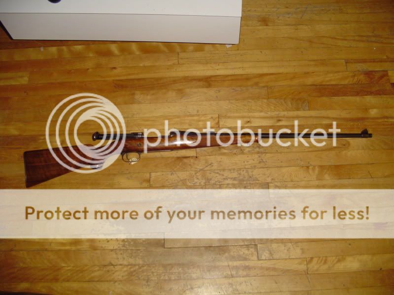

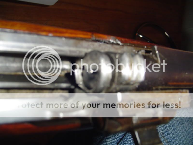

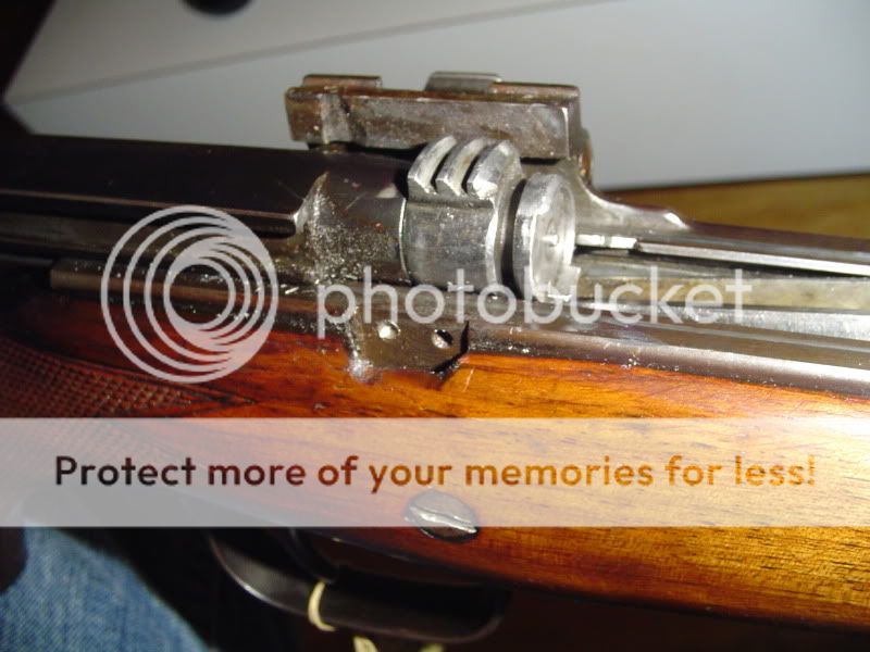

HI,
i have a neighbor that has a very nice commercial ross 1910 in .280, but the bolt is stuck for about 30 years! I have took a look a it today, but impossible to do anything... i have removed the rear sight to have a better look. I have also tried to disassemble the bolt, but no luck. I dont know how someone could put the bolt that bad. THe bolt is stuck uncocked halfway. Any idea?
Thanks, Fred
Take the barrelled action out of the stock. Remove the trigger mechanism. Tap the bolt handle back. (Block of wood + hammer).
I've seen a few 1910s jammed like this. The bolt assembly will come out.
thanks. I was thinking it would come to the hammer and wood... I cant remove the action from the wood because there is a screw that i cant reach under the bolt... is it best to tap on the bolt handle or on the bolthead?

Since the bolt head is fully exposed from the top...I'd think a block of hardwood could be used to tap back on it. But I'd be afraid of doing damage to the rifle in the trigger group area by pounding it back with the bolt head in that position. :eek:
Just looked at this one. I was visiting with SMELLIE this afternoon, and he discussed it with me.
The exposed firing pin is a big clue on this one. The bolt has been assembled wrong, and has been put into the rifle that way. As SMELLIE says, lubricate the area where the bolt is in the back of the receiver, particularly the slots and rails where the carrier is.
The 1910 Ross trigger mechanism acts as a sort of pivoted piece, with the back end being the sear, and the front end having a spring loaded piece to help keep the bolt carrier / bolt assembly forward. When the trigger is pulled, the sear goes down and this small "catch" comes upwards. I can not really tell too much from the photos, but it looks like your trigger is a bit too far towards the rear. If this is the case, and it could be if someone pulled the trigger while attempting to hit backwards on the bolt, the rear of the locking lugs are jammed by this "catch."
When hitting the bolt, do NOT use a steel hammer directly on the bolt. DO NOT HIT THE BOLT HANDLE ITSELF, AS IT CAN TWIST AND JAM THE BOLT, POSSIBLY GETTING IT EVEN MORE OUT OF LINE.
Lube the bolt area as outlined. At this point, it is wise to have a friend with and extra set of hands available. If the bolt is jammed on the catch, you are going to have to take a block of hardwood as a "punch like tool" and hit the back of the bolt firing pin assembly (the main body part, not the bolt handle,) so that it can go FORWARD about 1/16 inch or so. This will free up the catch. Then try the brass rod inside the bore and attempt to hit the bolt backwards.
As CANTOM suggests, it might be possible to use a longer piece of hardwood to hit the bolt head backwards, but if you do this, you are hitting at an angle, and not straight back. Have your friend hold the rifle securely as you are doing this.
Even with all this, it is possible that some damage will occur to the "catch" and the trigger assembly. Whatever you do, once you have the "catch" loose, do NOT pull the trigger as it will only jam up again. Once the bolt head is back near the rear of the receiver however, it might need to have the trigger pulled so that the sear goes down and allow the bolt to be fully removed.

Oops. The last one brought to me in this condition was a barrelled action.
The jammed bolt is created when someone forces the bolt into the rifle with the bolt in locked position in its sleeve. The bolt has snapped back into the sleeve, rather than being extended out. To go into the rifle, the lugs must be horizontal, not vertical (on a 1910 action).
With the lugs vertical, and the bolt back into the sleeve, it is in locked position, not the unsafe position. Unsafe is when the bolt is back into the sleeve, but the lugs are horizontal.
It is going to take a bit of force to remove the bolt assembly from the receiver.
Once the bolt assembly is removed from the rifle, pull then bolt foreward out of its sleeve, and turn until the lugs are horizontal. It will likely have to be held this way until the asswembly is run into the receiver.
Did someone remove the extractor in an attempt to get the bolt assembly out?
Hi,
yes i have removed the extractor in an attempt to try to disassemble it, but the bolthead need to rotate to get out of the bolt assembly, so it is not working...
The only way you can rotate the bolt is if you could pull it foreward, out from the sleeve, rotating it until the lugs are horizontal. Doubt that you will be able to do that with the assembly jammed into the receiver. Try it, see if you can pull the bolt foreward, against the spring, but I doubt if it will move.
The bolt assembly has to come back and out. It was forced in, with the bolt in locked position. It has got to come back out the way it went in.
Just to clarify. Bolt = the part with the locking lugs. Sleeve = the part with the handle.
i just did it!
I left the bolt partly disassembled (cocking piece and pin removed). I then tried to push the bolt forward like suggested. It worked and went fully forward. The bolt had now enough space to open a little bit more. With the help of a rubber mallet, the bolt and sleeve finally separated and i didnt had to pull the bolt backward, just the sleeve.
