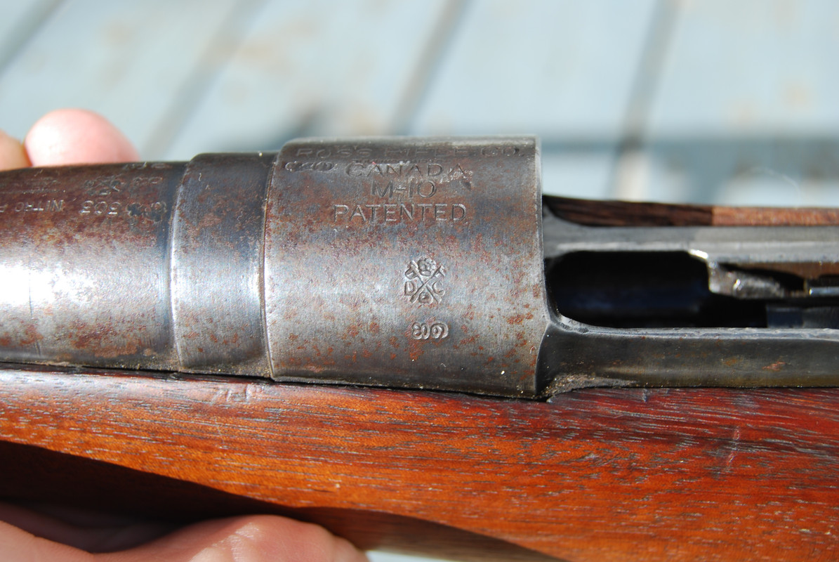

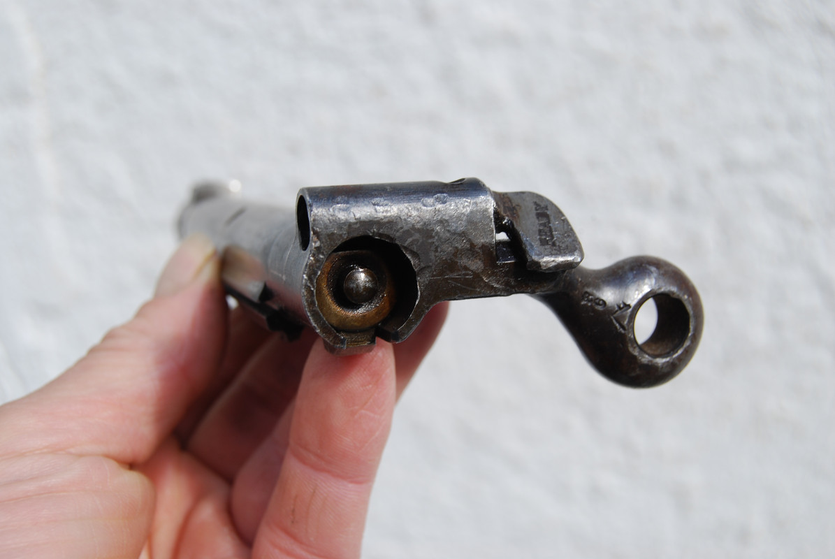

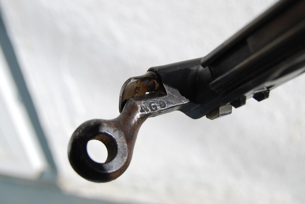

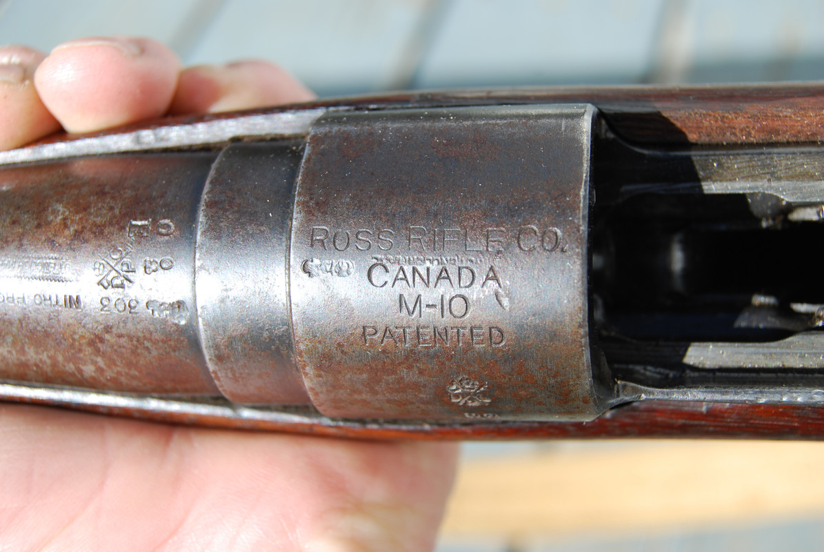

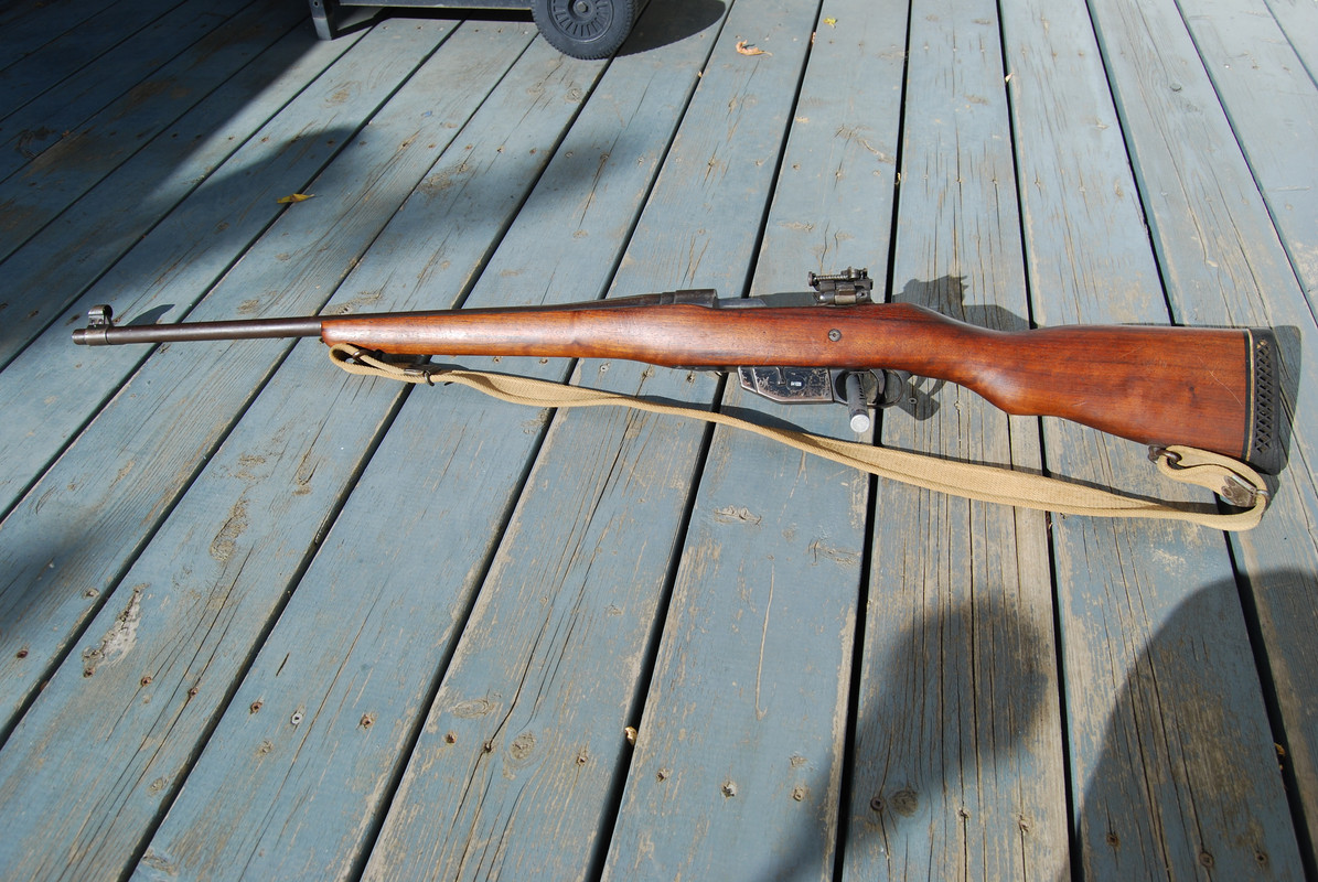

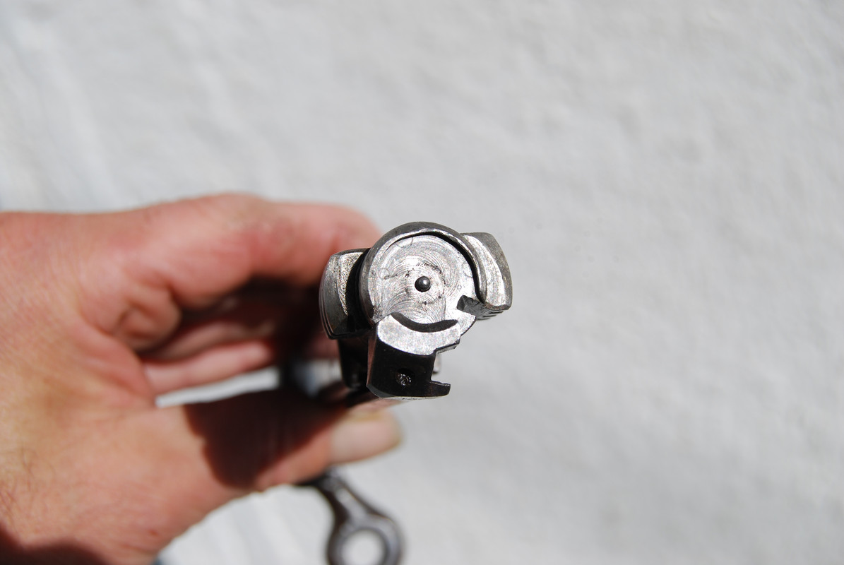

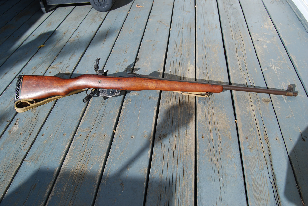

So looked at a sported Ross M10 this past spring. Its been sitting for 40 years or so and never shot. Last time it was shot was probably at a coyote and then put away. Now this is one of those farmer finds we all like. So I was out there today and asked about the old ross casually and was told I could have for a lot cheaper then the price was this spring. The bore is dark so I said I will take it and clean it up and go from there.

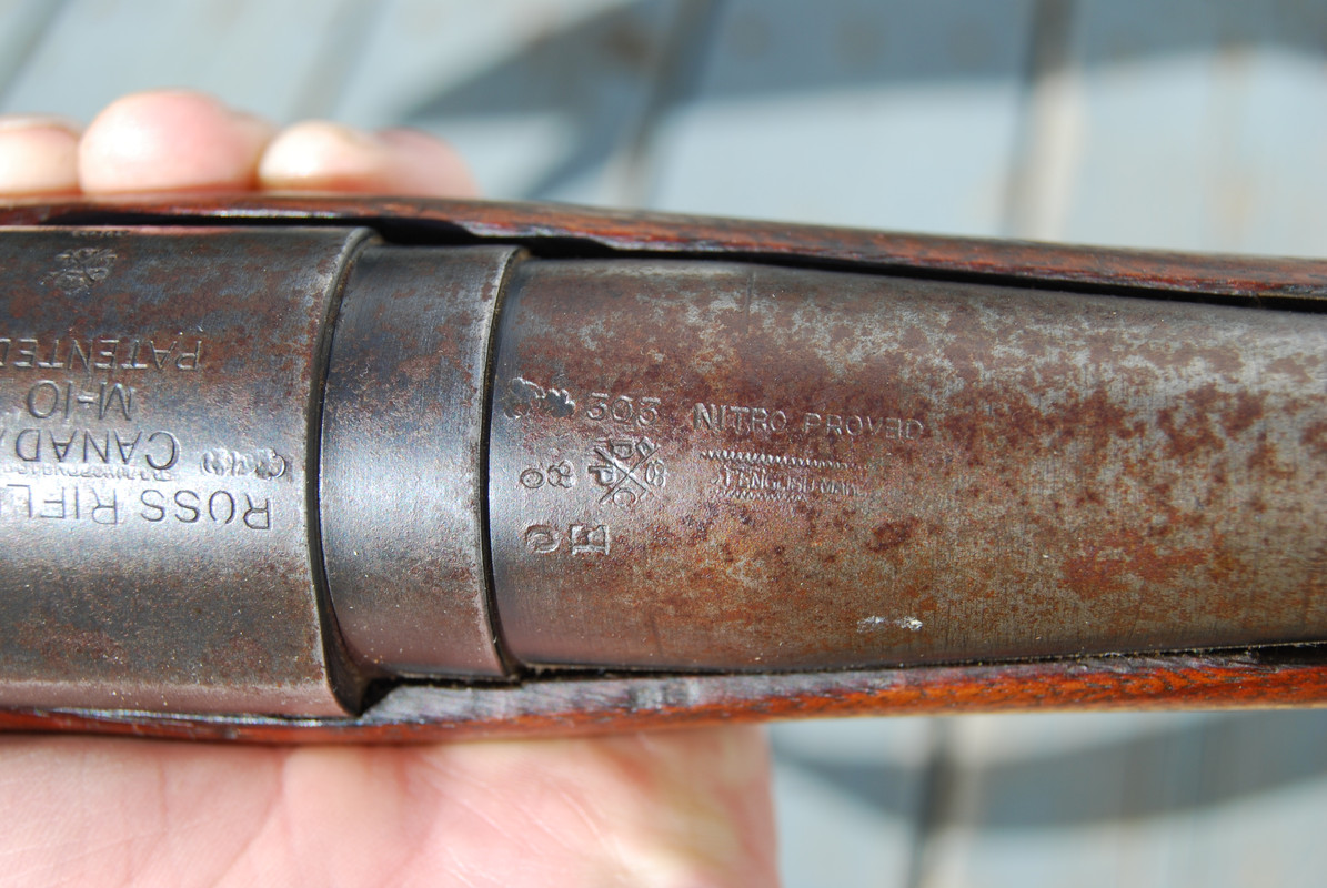

So the question is,where am I looking for numbers on it? I know nothing about these rifles but all the steel appears original but the stock was sported. But still I have never owned or even shot one so I had to jump at the chance. I took the bolt out which was like dry oil seized and its been sprayed down.
So any help would be appreciated...

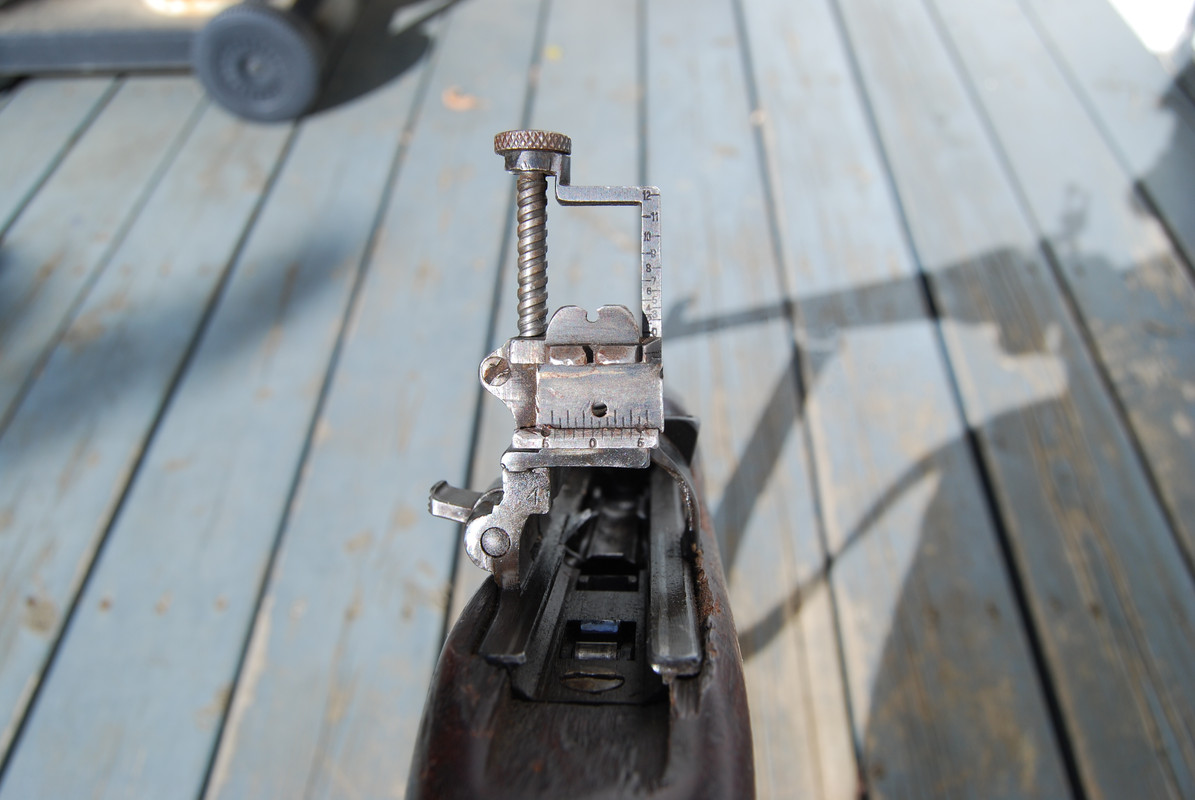

If it is an ex-service Mk. III rifle, the serial number would have been stamped on the right side of the butt - a combination of date, a number and letters. These often disappeared when a stock was sported and refinished. Folding aperture sight on rear bridge - service sight. Some Mk. III rifles which saw British service have serial numbers stamped on the receiver ring.
If it is a factory sporter, there will be a little serial number stamped on the left side of the breech, just above the stock line. In addition, a service barrel is quite chunky in front of the receiver, while a factory sporter barrel tapers quickly. A factory sporter had barrel mounted open sights.
A photo would really help.

30.5 inches on the Mk III and they had a heavy barrel, quite a beast to haul around and for that reason most sporters are shortened.
Well that pretty much does me for buying it. I didn't know what the original barrel length was but me seeing the front sight I was hoping it wasn't cut down. So really all that is worth anything is the sights,cross bolt, misc pieces, trigger assm,mag assm...I don't need a sporter!!

I haven't bought it yet. I told the fella that I would clean the barrel out and we could go from there. So technically,its still for sale!
well it looks like it might be a nice sportered example of the ross mk111 and like i said if the bore is deacent then i wouldnt hesitate to buy it .They are accurate and a peice of canadian history .I think you will enjoy it .I saw one similar to yours with the original site sell for 650 on one of the dealer sites a while ago,do some reaserch on the ross history and go from there.Very interesting rifle with a more interesting history.Buy it shoot it ,enjoy it.
I can get this one for probably 1/3 of the price you posted..

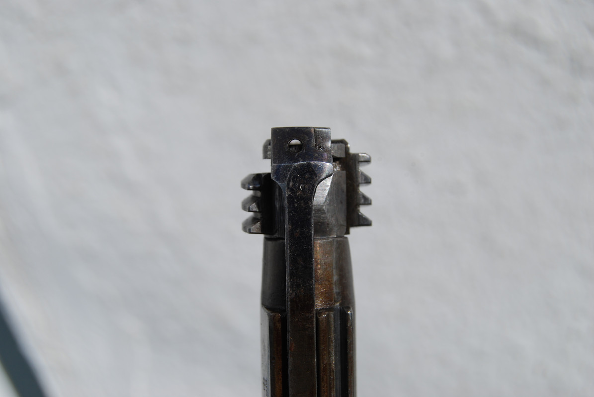

I would suggest that $650 for a cut barrel Mk. III sported rifle is ridiculous. Icehunter121's one third of that is more realistic. Assuming that the bore is good enough to be a decent shooter.

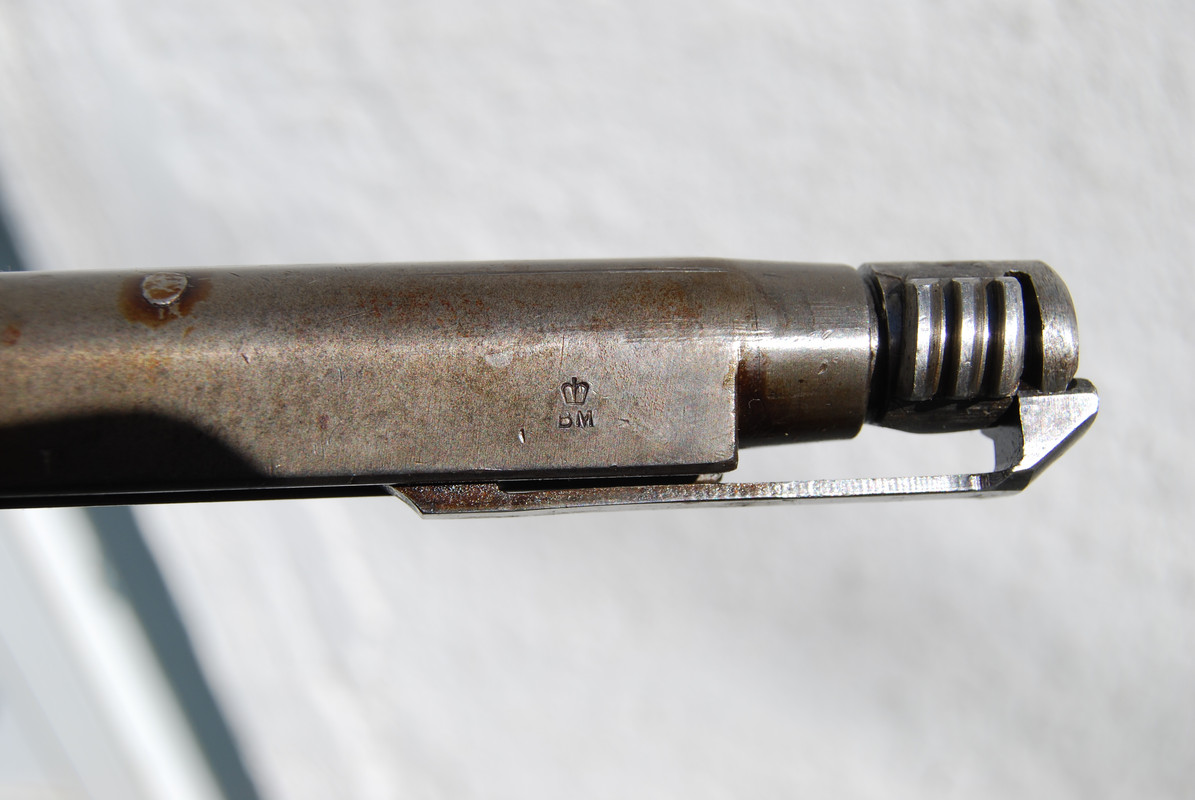

The rifle appears to be one of the ones commercially sported in the UK in the '50s, based on the proof marks and the style of alterations. The rivet in the bolt sleeve suggests that the rifle was in service during WW2.
There is some confusion regarding Ross Mk III chamber sizes. The following is my understanding of the situation.
The Ross Mk III was initially manufactures with the same minimum-spec chamber found on the Mk II** target rifle. Due to chambering issues with out of spec wartime ammunition, Ross changed their chamber specs. The new chambers more closely resembled the chambers found on the Lee Enfield No 1 Mk III, but are slightly larger. New Ross Mk IIIs with the larger chambers left the factory with an "E" stamped on the barrel reinforce. The "E" does not indicate the chamber was enlarged at some point post manufacture. The chambers of rifles in service were enlarged at armories, and the barrels were stamped with an "LC" or "N". I have never seen an "N" stamped barrel. Although I am not certain, I suspect the armory enlarged chambers were significantly larger than the factory "E" chambers. I intend to do a chamber cast of a recently acquired "E" stamped barrel to confirm my suspicion.
