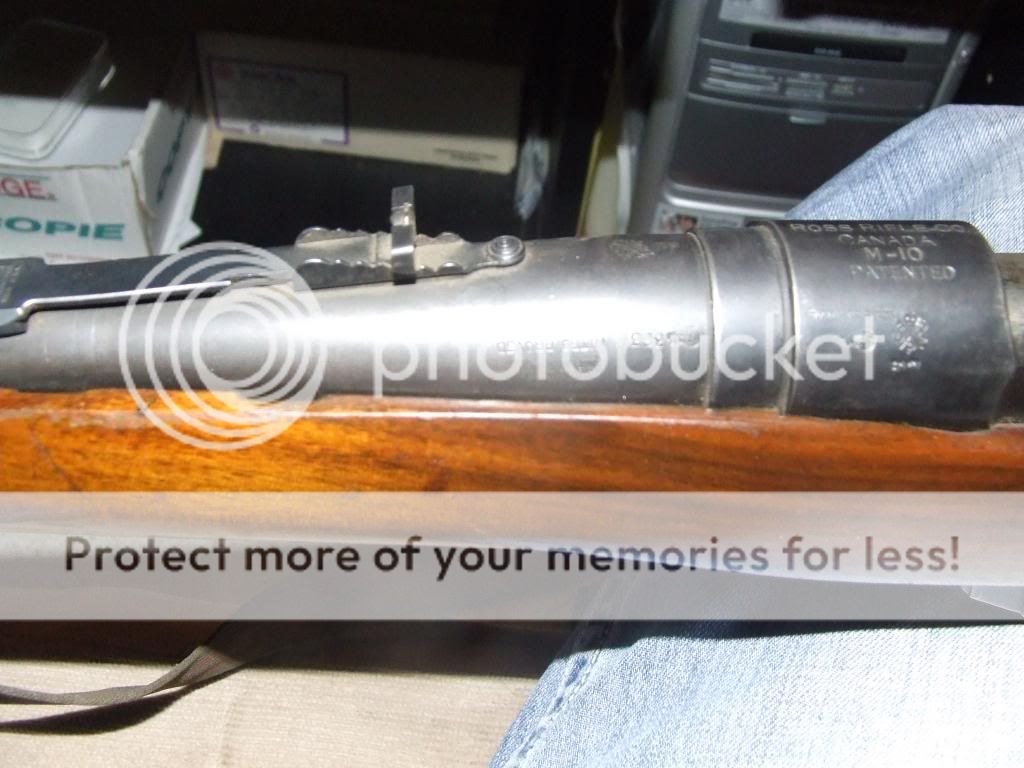

I, too, find that the photos....... uh...... "lack definition", to the point that accurate replies are compromised more than a bit.

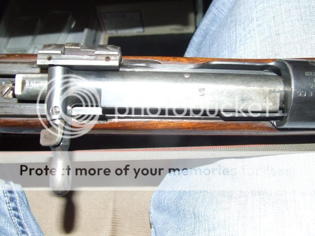

The close-up which begins the thread shows a Bolt which is assembled CORRECTLY.
OP: do yourself a really HUGE favour and read the Stickie. This rifle has the 1910 Ross action, the strongest ever made, but it COULD be assembled in a dangerous condition. This one is okay right now, but DO be careful if you remove the Bolt any time. You MUST have that inch of clearance between the Bolt Sleeve and the Locking Lugs, else the Lugs cannot rotate in order to lock up.
You think the rifle is accurate now? It will be TWICE as accurate with the proper rear-sight assembled. You need a complete Mlitary-type Receiver Bridge for a Mark III Ross Rifle, with the Ross Battle Aperture Sight and you need the 4 tiny screws with which to mount it. The Screws are a standard thread; all Ross screws were to US standards: no oddball threads. This sight is fully adjustable for shooting with military ammunition but it also may be used for commercial ammo AND it is fully adjustable for wind!

Is this bolt assembled right?
It is missing part of the rear sight above the bolt? Is this needed to safely fire the ross m-10? Will the bolt pop off and hit me in the face?

It is possible that the forward part of the bolt can come out of the helix and be put back in the rifle so when the bolt is pushed closed the lugs do not twist and lock the bolt, they only sit in place. In that case the bolt head is against the bolt and is quite a bit shorter. If at all unsure you can take a light and shine it where the bolt head locks into the receiver. You should see the lugs twist into position in the receiver threads. I have not had the pinned bolt that supposedly cannot be assembled wrong, but there are other threads on the subject.

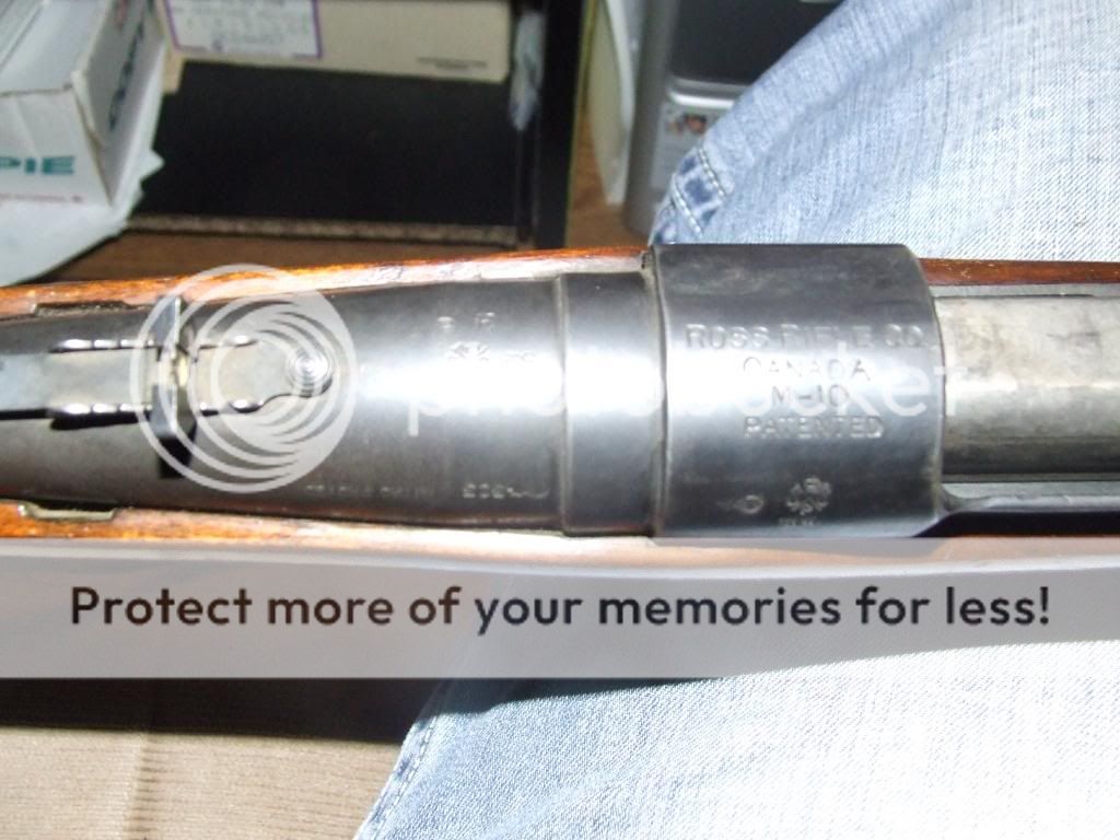

I have some better pics!!!!!!!!!!!!!!!!!!

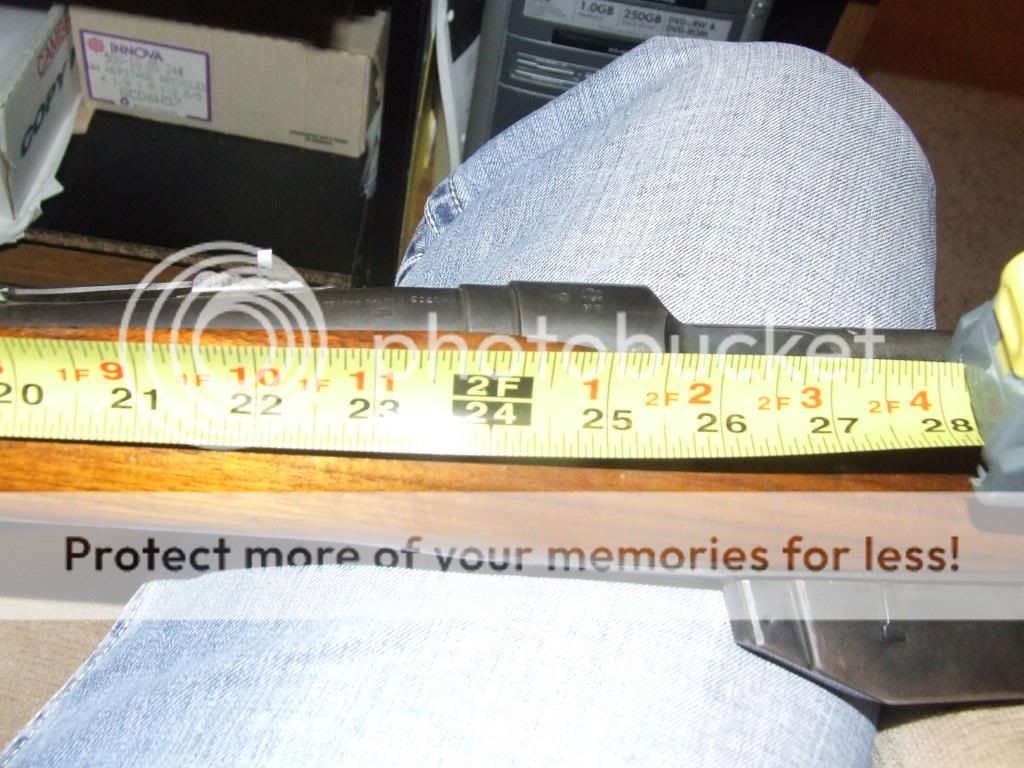

has this barrel been cut?
It has the Letter E on the top.
No serial numbers anywhere but there is a BM on the bolt.
Tell me what I got? Please. I would like to find the right rear adjustable sight.
I think it has the heavy barrel and no barrel band.
"E" means that the rifle has the enlarged chamber.
The serial number would have been on the right side of the stock; disappeared when the stock was sanded.
Is the barrel about 2 1/2 feet long? If not, it has been cut.
You have a sported Mk. III service rifle.
Put an ad in the EE for a rear sight bridge complete with sight and screws for a Mk. III Ross rifle.

The E mark is not seen on Commercial Sporting rifles; it is a Military marking.
FULL Length on the barrel when made was 30.5 inches.
Original Commercial Sporters used 94 Winchester rear sights, but NOT where this one has been placed.

Personally, I would like to have a close look at this rifle for markings which might let us know a bit more of its history. The DCP with crossed flags and Crown was the Dominion of Canada Proof marking. It was applied at the Ross Rifle Company factory by Canadian Government Inspectors who inspected every rifle as it was made. The standards for the Proof Test were the same as for an English proof, but the Ross action was MUCH stronger than anything else being made. Get the right parts onto her and this one should be a Shooter!
