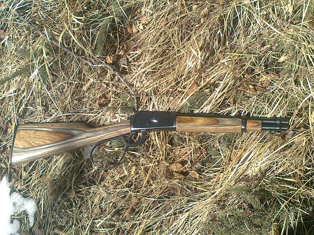

I've got the .44mag ranch hand and put a full stock on it, and it's a great little gun this way. .44mag is more than enough for a deer as well. The full stock mod IMO is the best mod you can do. I ordered an unfinished stock from Boyd's and had to sit with a dremel for an hour or so to get it to fit right, then it's good to go. Makes a great bush gun
In this case bigger is better. I did my .44 mag with a stock from Precision in Texas. Just a little final fitting and cut the end for a rubber butt pad. Makes for a super fun gun to shoot. I use plinking loads 200 gr cast over 6 1/2 gr Titegroup. For serious business, 300 gr XTP over 9 gr Tite group does good. The carbine stock is a must in my opinion.
I saw your post on you modifying your large loop lever, how hard would it be to swap it with a factory lever? the large loop levers are ugly IMO. and is it posible to shorten the action? and thanks for your thoughts on the ammo :D

I hear ya, that's where it beats out my short barrelled 12ga. It's actually a really light lever, very easy to carry around all day. Do this mod and you won't look back.

Right on, I think I will just take a trace of the stock with me and go see what's on the shelf.....A couple of nice straight grained stocks just showed up from PGW!
I have a PGW Rossi Carbine stock on it's way and will be making a brass
butt plate for it, rather than blowing cash on one of their steel plates.
When it comes to sights, I've found that for my eyes, a Marble's 538"
tall front sight works best with the 1/16" bead portion of the sight removed.
I carefully stoned off the bead part of the sight and sloped it slightly forward.
This worked out leaving me with a front sight height of .500" and a nice, thin
blade to better place shots on small targets at 75 yds. This front sight mod
in conjunction with the Marble's Bulls-Eye rear sight lets me get on target both
quickly & more accurately.

Glad you got it working for you Shelly! I prefer a small bead myself over a square post.
Are you going to make a crescent style brass plate or cut it back square?

1) Yes, and yes... (unless you were in the group-buy, then it was almost not worth it)
2) Check Ontario's hunting regulations, caliber restrictions specifically. (but I think anything .30cal & up is good-to-go)
3) I'd "go big or stay home"... I have a .44mag, so I may be biased. :)
Is this what you're looking for...?
