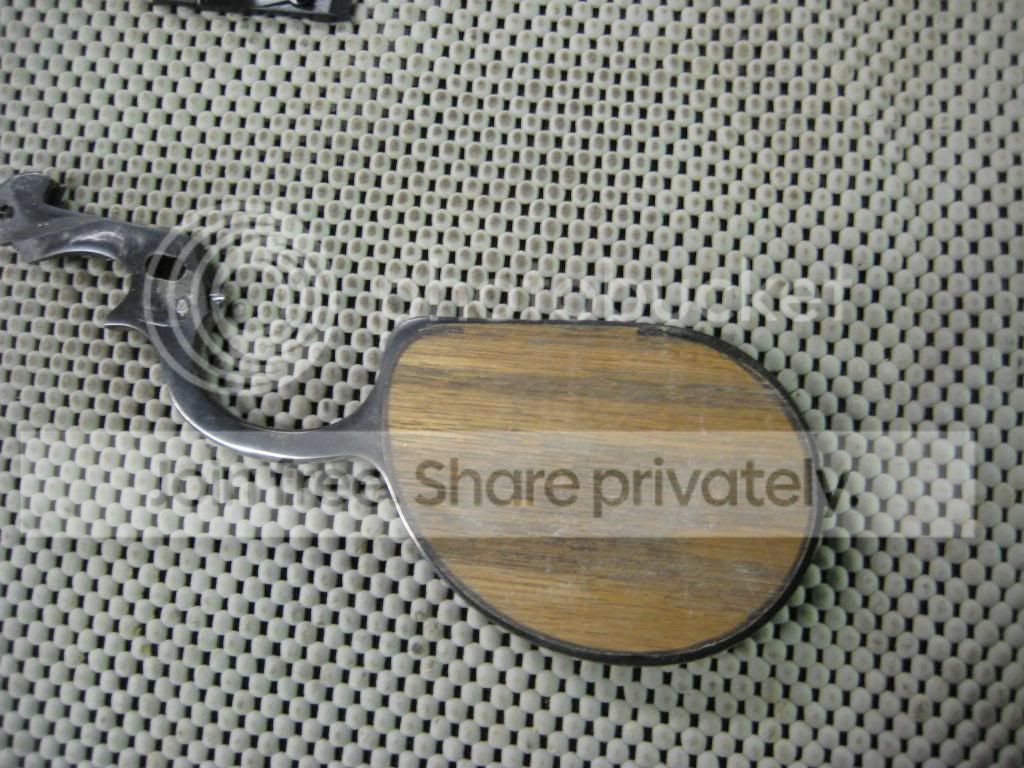

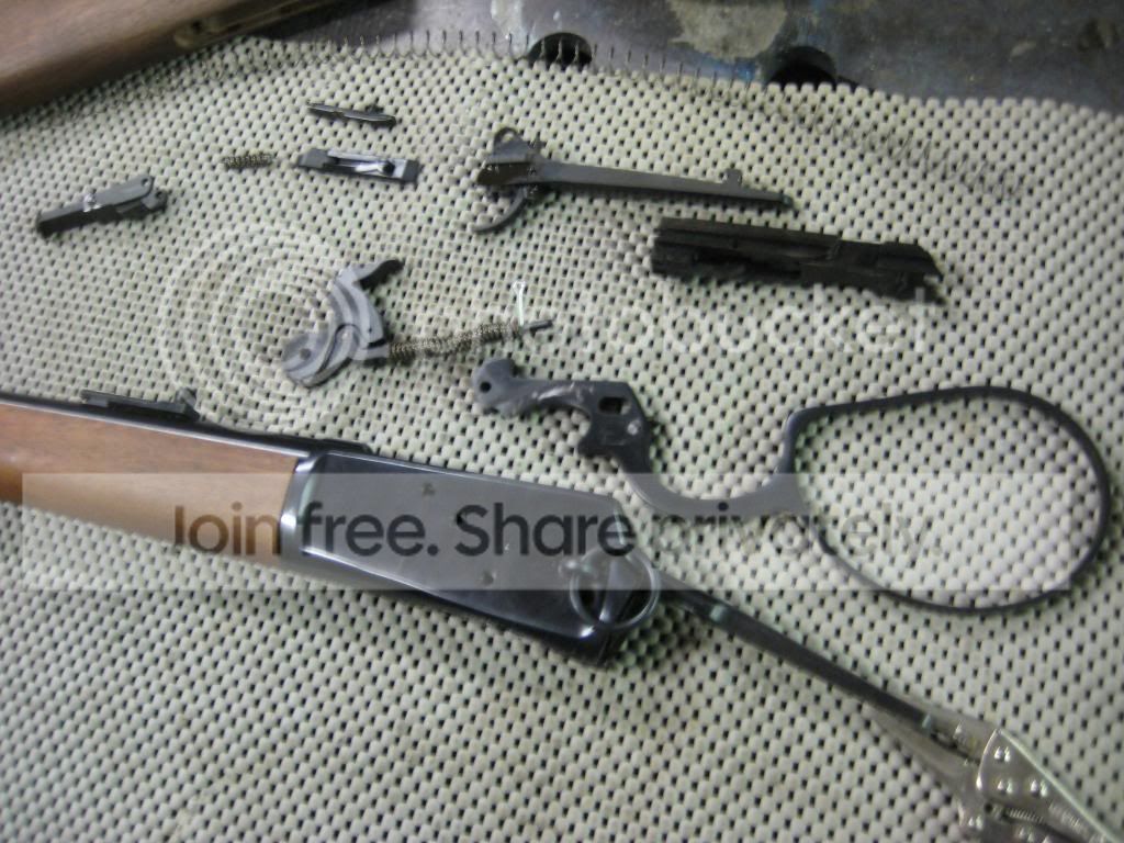

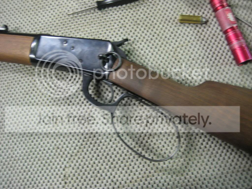

Crappy day out today so the Ranch hand was the day's project. The video is required as far as I'm concerned. Shouldn't have taken it all down, pain to reassemble. Made the lever somewhat smaller but still big enough for a gloved hand. Put in the metal follower and new ejector spring too.
Looks pretty good MB, Did you just clamp it in a vice without heat as well? No cutting? My Ranchhand is pretty smooth and the ejector seems fine(I have another rossi with a very stiff ejector), but one day I will take it all apart like that and take the time to smooth out any sharp edges and polish the wear spots a bit.
Didn't use heat to bend the shape, cut out about an inch of the ring. Cut the wood form a couple of times to get what I thought was a good size, basic shape formed on the wood and final in the vise and tig together. The weaker ejector spring keeps the casings from going too far, just flicks them to the side for easy recovery. Didn't do any other mods shown in the video.
