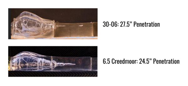

As an aside, always thought it would be really interesting if someoe who hunts a lot, like you or a gun writer or something, compiled a list of distance an animal travels vs whether or not a bullet exits. As long as it reaches and passes through vitals, I'd imagine the relationship is very weak, but open to being proven wrong lol
If this happens in the vitals, round nosed bullet or not, exit or not, the left side is a lot more important than the right side of that wound track...with CNS hit or being overwhelmed being much more important a factor in dropping an animal on the shot.
[/img]
What I bolded is ideal, I think, but I've taken many, many deer that fell down like 100 yards away from where they had been hit - the bullet killed them - is like they did not know that, when they took off. If you are shooting at animals to kill them, perhaps need to learn about tracking and follow-up - has been many times I have finished a deer or elk, sometimes hours after the first bullet hit - is not ideal, but it happens. Too much today about expectation to fire and see the thing drop dead - it might happen - it has happened to me - but I would not consider that to be the "normal" sequence of events. Is more typical to aim and fire - then a follow-up - and find the thing dead or nearly dead. Because the thing ran away, does not mean it is not dead - that longish shot I took to get that deer - we fired at it at least 4 or 5 times after my first shot - after it crossed a fence - I could see fine blood spray on snow, when I walked up to look at its tracks - actually to determine how it had crossed the fence without jumping over it - it had gone through an open gate that we could not see from where we were shooting from - it had totally bled out by the time I found it - yet our son, my Dad and I saw the big jump - high waving flag tail as it entered that poplar bush - all of us were convinced it had not been touched, yet it was laying perhaps 4 paces into that bush - stone dead - at least 200 yards from where it had been, when I first fired at it.
Exactly :)
In the quote responding to people saying that a round nose, or an "energy dump" knocks animals down with saying that the only way to reliably drop an animal on the spot is to stop CNS function.
Round nose vs flat nose or exit vs no exit has very little to do with an animal not going anywhere, IMO.
