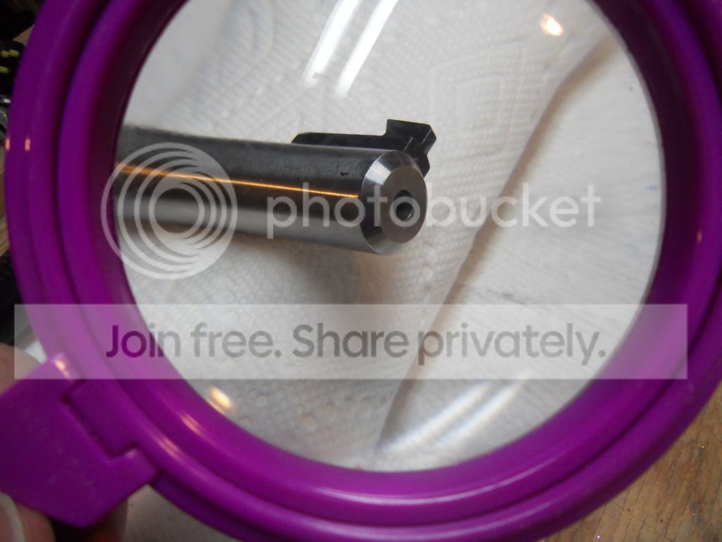

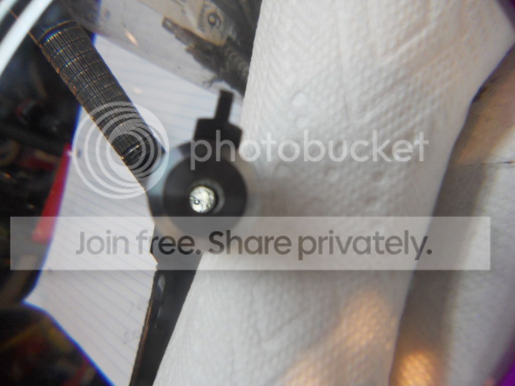

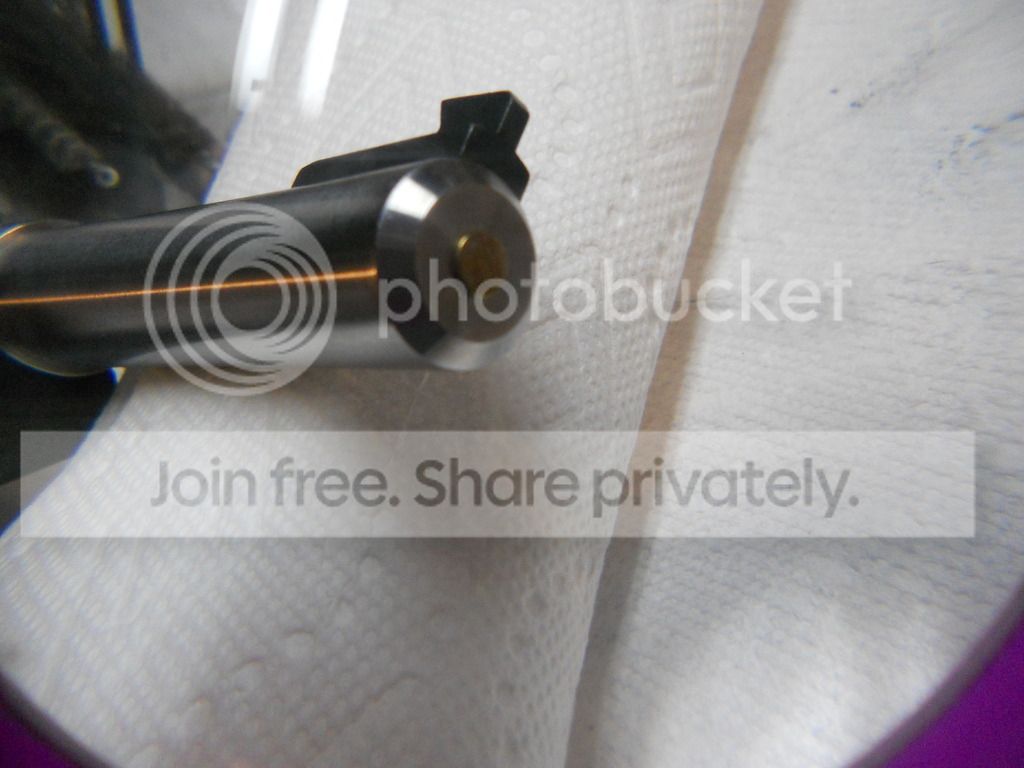

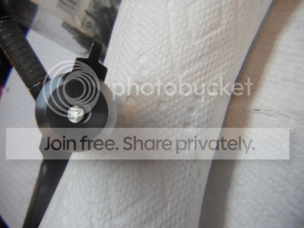

I have a stainless mkII variant 22/45 and had an identical blued version. Both 5.5" bull barrels. The rifling in the blued goes to the crown whereas the stainless barrel appears sleeved or counterbored around 3/8" in. Anybody know if this is a factory thing for the stainless barrel or perhaps a past repair to the crown. If it is a repair, whoever did it did an excellent job. Thanks
Crown measures 0.250" and smooth 0.810" in then ridge/ring and rifling begins.
22 case easily inserted

For mine, the exterior appearance both look identical. No indent for a recessed target crown. When I look down the barrel it looks like a reburb Mosin nagant barrel that was counterbored. Near perfect smooth bore about 3/8" in, with a very defined ring then rifling is visible.

Thanks for the responses so far. I have since posted on rim fire central and ruger forum net. Also emailed ruger. I can take a picture as requested but there will be nothing to see as tip of barrel is smooth like a regular bull barrel, I won't be able to get a pic of the inside of the bore, too small for my camera to focus.
