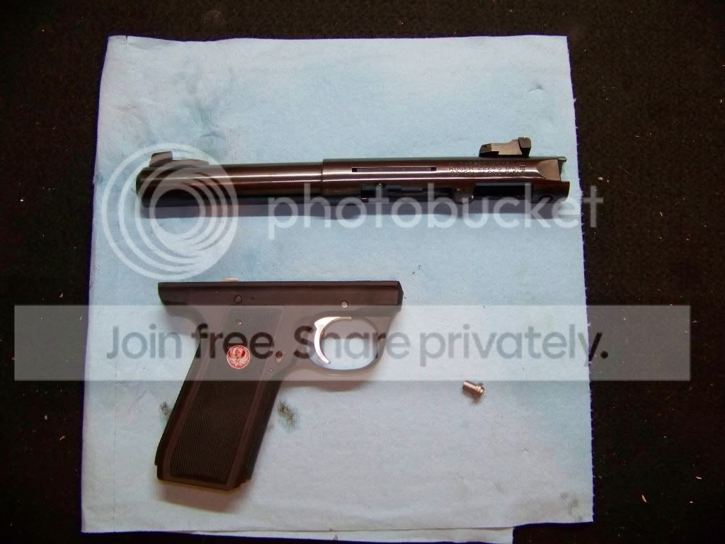

To install the bushing you must strip the pistol down to the frame with the barrel removed. I followed this page and it came apart easily: http://www.guntalk-online.com/2245detailstripping.htm

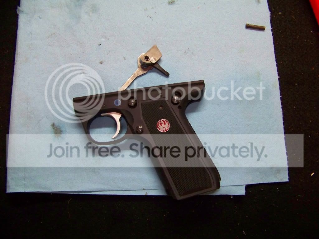

Pistol stripped, with the replacement bushing seen in the lower right corner of the frame:

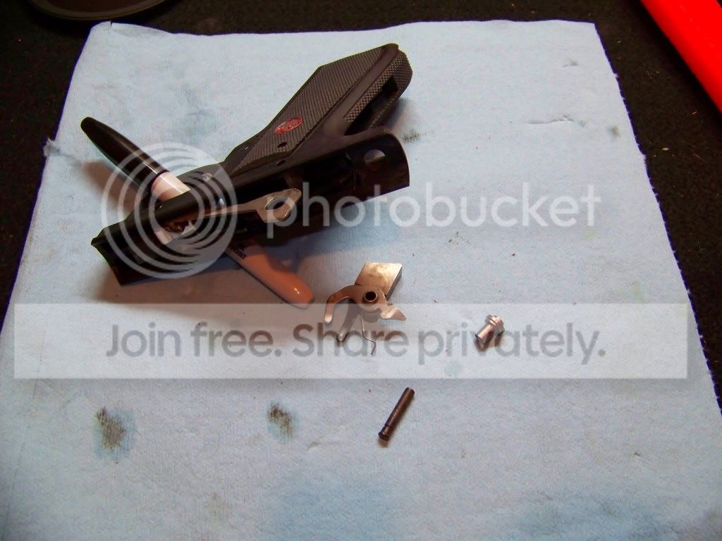

This shot shows the frame from the top, with the hammer out and the mag safety pieces still on the hammer. The replacement bushing is to the right and the hammer pin is at the bottom of the frame:

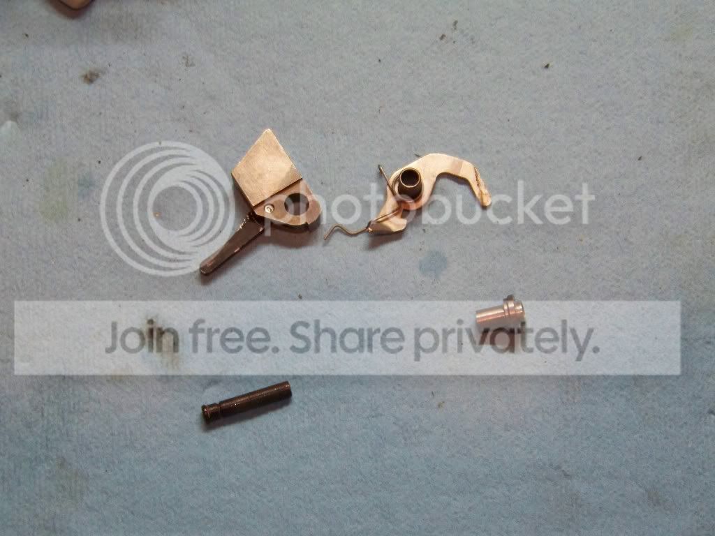

This shot shows the hammer with the mag safety pieces beside it. These get removed and the bushing put in their place to keep everything spaced properly on the pin.

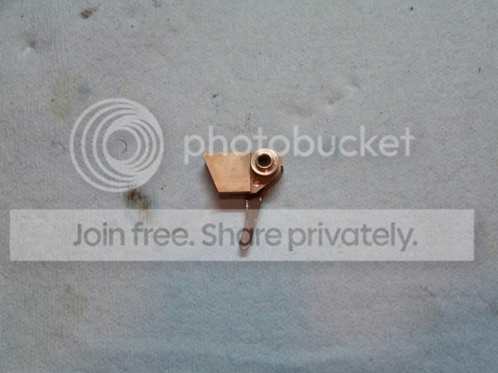

The hammer with the bushing installed:

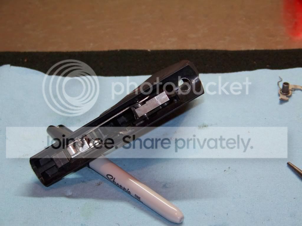

A shot showing the frame with the hammer back in. You can see the bushing on the trigger bar side of the hammer:
