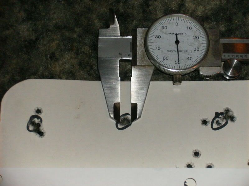

Each is entitled to his own opinion, but i disagree. This was shot with my 77/22 at 50 yards with a $75 Green Mountain stainless barrel in it, the two groups beside were one before and one after using Remington subs. I have also recrowned and rechambered the original barrel, and it will shoot 1/2" groups regularly at 50 as well. I really do hate the 77/22 bashing, especially from people who have never owned one. I understand that the bolt is a bit different on the magnum and 17hmr models, so headspace could be an issue if you start with those two calibers. I have shot magnum with mine and it shot just fine. I have 4 barrels and 3 different cailbers for mine as well. I have since bought a 77/17hmr and is shoots very well, first groups were in the 7/8" range at 100. There is lots of info on caliber swaps on Rimfirecentral. JMO
