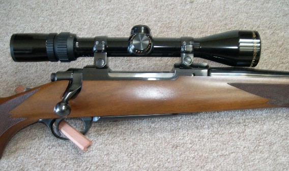

I currently have one Model 77, a nice "like new" Ruger 77 "tang safety" model in 7x57 Mauser that I got off the EE in one of the very first incarnations of CGN. I've shot a 5/8" 100 yard 3 shot group with it with factory IVI 139 gr ammo.
