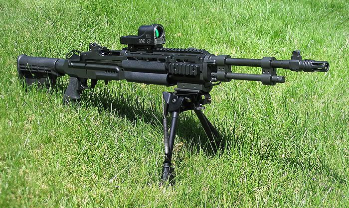

IMO there are 3 main detriments to the Mini-14s accuracy, and 4 to the Mini-30s.
-thin whippy barrels. can be corrected easily by hanging a weight off the end of the barrel, the steel flash hiders are ideal for this, inexpensive and easy to install. this would be my first upgrade.
-the action is very aggressive (for reliability), but this can be toned down by installing a smaller gas port bushing.
-heavy trigger like the M1As.... not much you can do about this.
-the Mini-30 further suffers from poor quality factory ammunition. you could be firing milsurp 7.62x39mm ammo out of a benchrest rifle and still not getting sub-MOA.
Yeah you guys are right. If you are going to cheap out on the ranch mini-14 then yes you won't be able to hit the broad side of a barn yard! I don't call 5 inches "grouping" i call that all over the page. However BUY THE NEWER MINI 14 TARGET version and you will not be disappointed. I had shot this thing out the box and was pissed off myself because I was all over the page chasing my scope for about 120 rounds!.....that was until I finally adjusted the balancer on the barrel (as I didn't think it would have made much difference in the beginning) and about 30 rounds later I was touching bullet holes at 100 yards with cheap factory ammo! I love the barrels in these things as I can put 30-40 rounds through this thing and the barrel doesn't even copper foul.... well worth the cash! The one downfall is that it does beat the sh*t out of your brass. And if you are a reloader like myself it can piss ya off not to mention it throws the brass about 40feet. Hope this helps.
