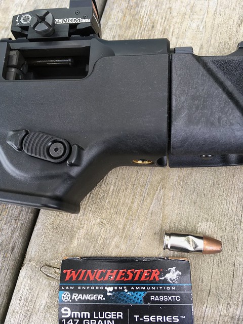

Was out plinking this morning with the PCC, and had a click instead of a bang. Or maybe the trigger didn't reset, or something. Anyways, the was a round 2/3 of the way into the chamber and it wouldn't extract but a few taps on a fibreglass rod run down the barrel and a somewhat malformed round popped out.
Anyone else see anything like this? I'm not sure if it was messed up when the preceding round chambered or during its own cycle.
