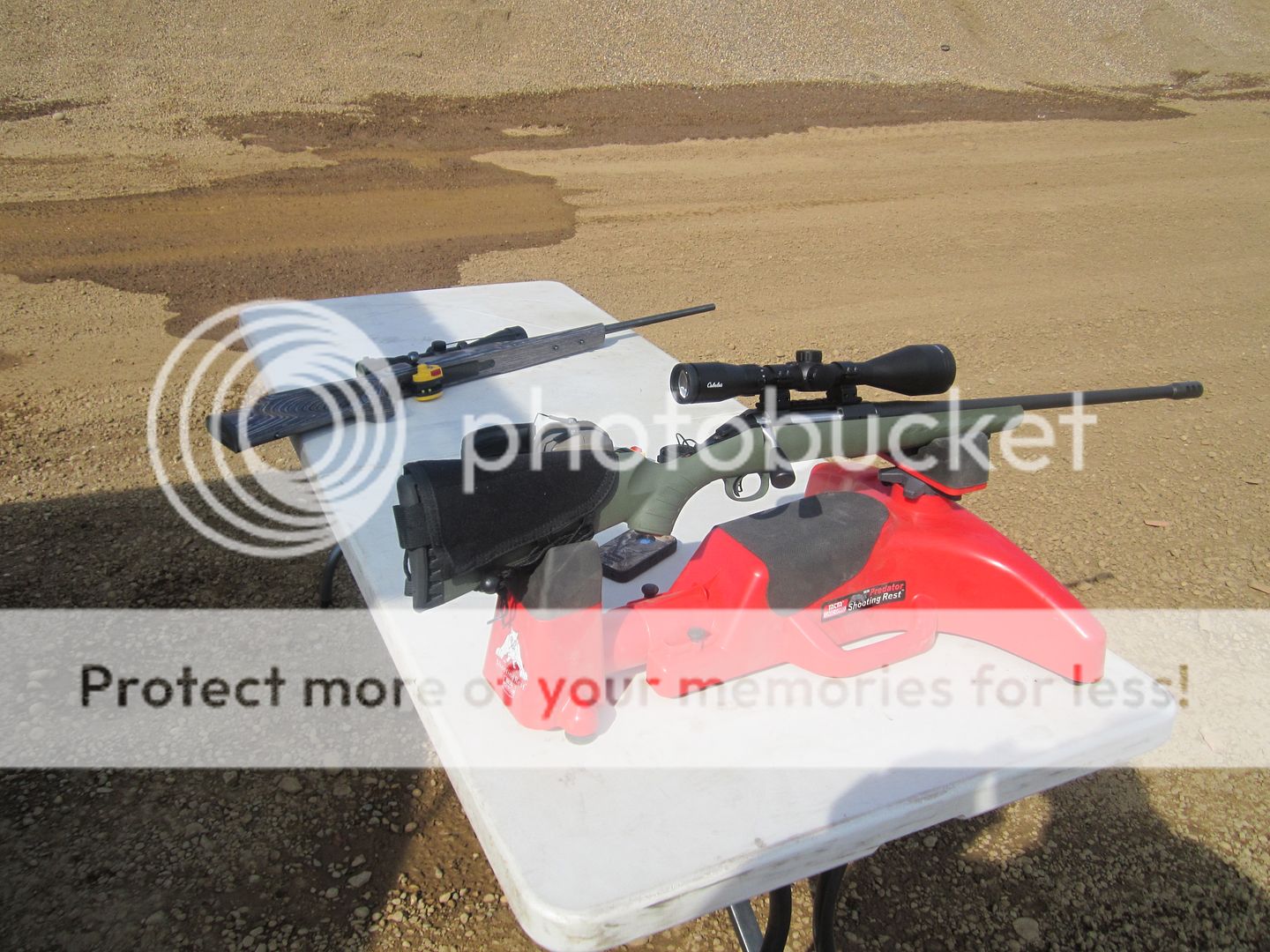

the ruger
the Weatherby
the set up

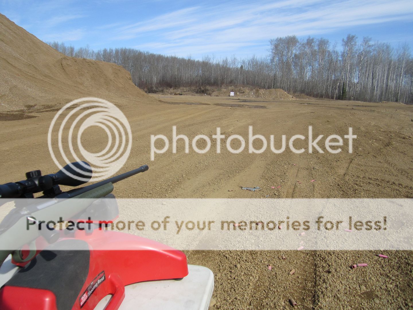

the range

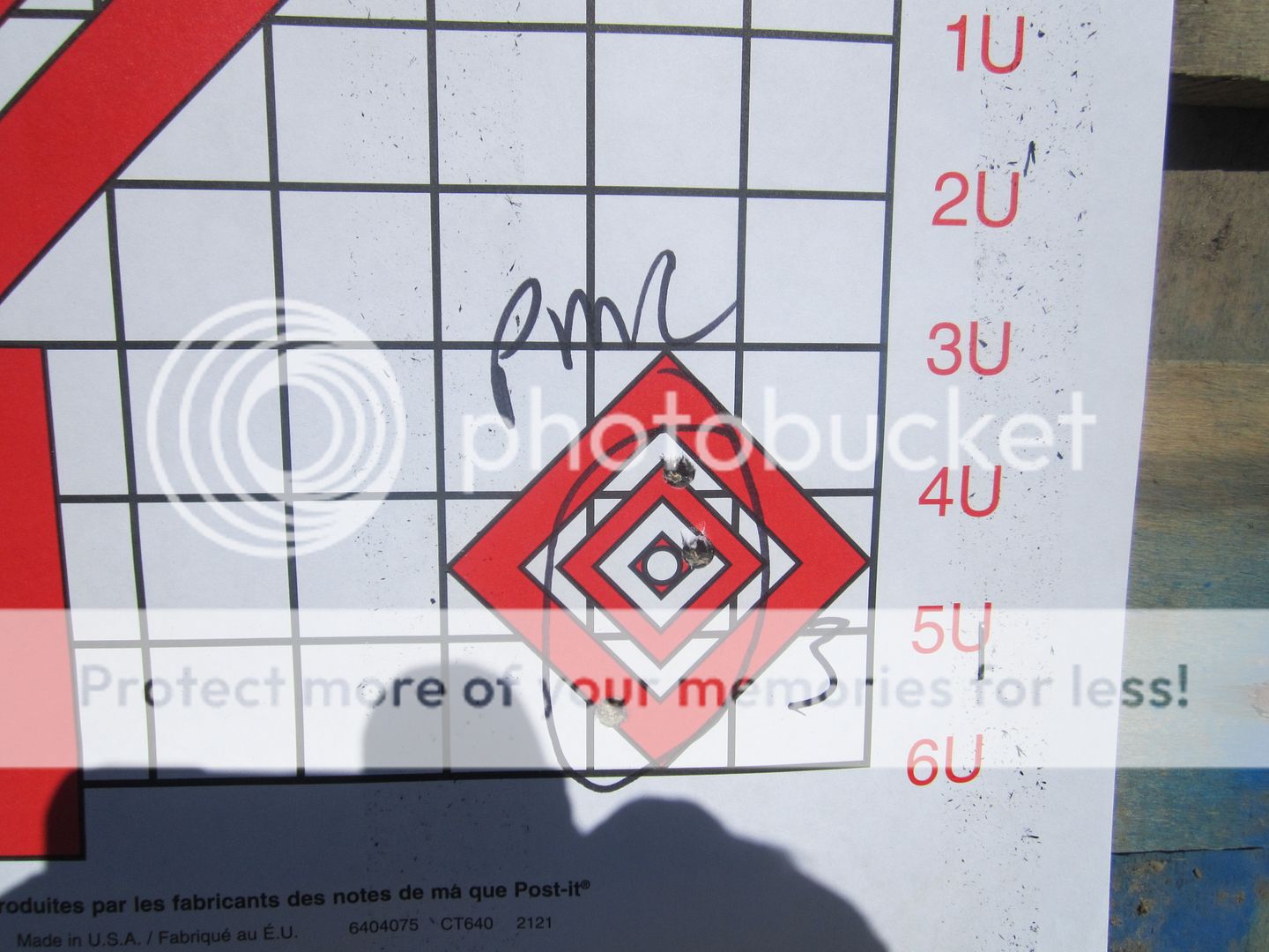

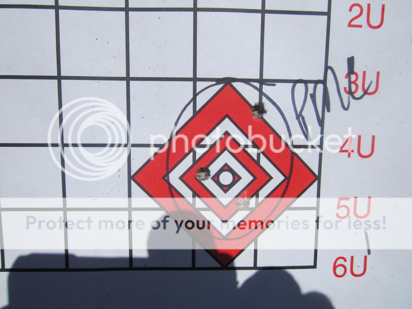

Ruger 3 shot groups @ 100 yards

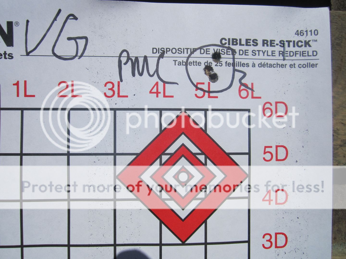

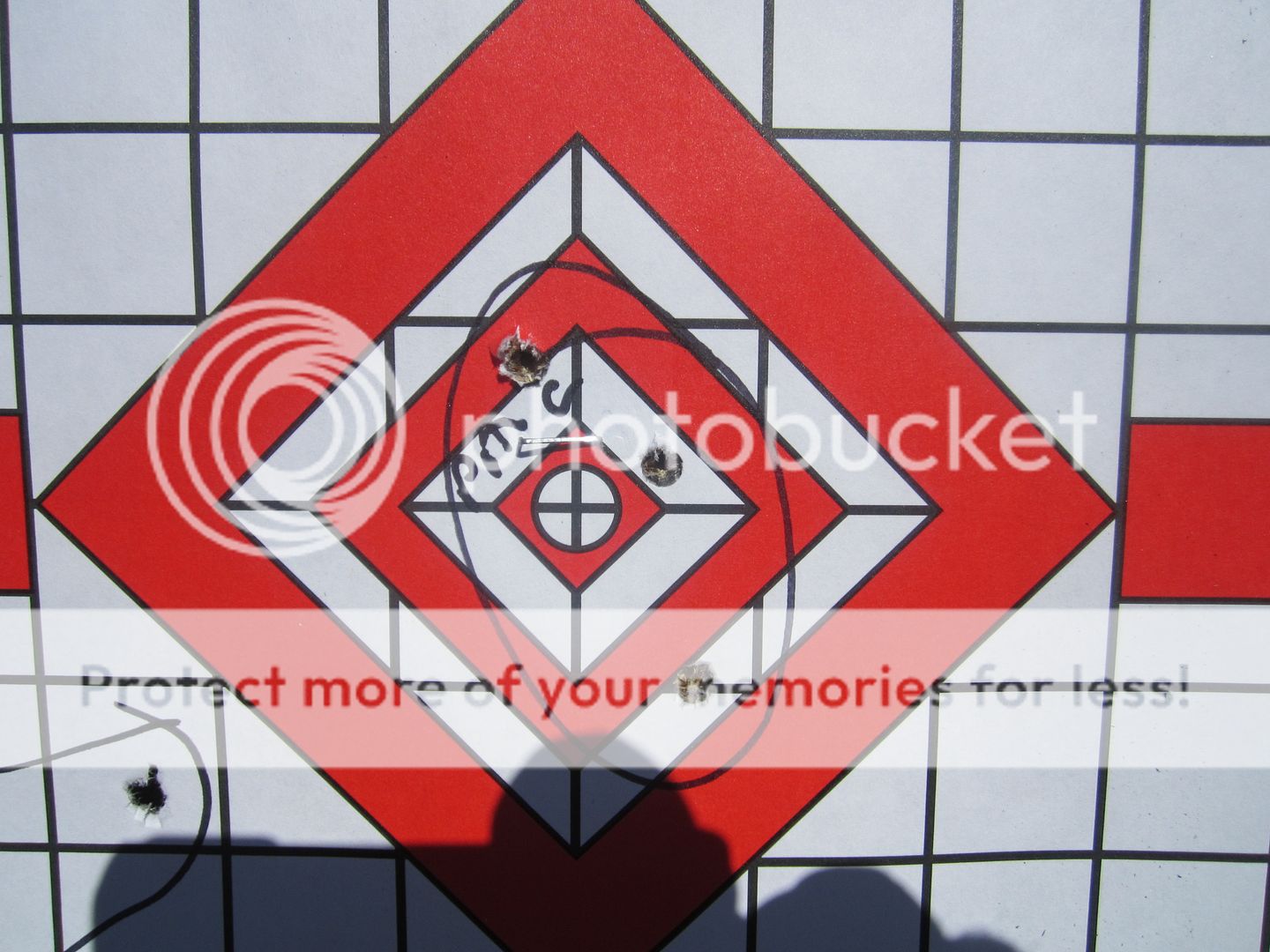

Weatherby 3 shot groups @ 100 yards

it was cold, around 0 to +2 out with a strong wind, not ideal shooting conditions.
we ranged out the distance to exactly 100 yards.
the 2 targets for each gun listed above where the last couple groups we did.
while they may not be the best groups of the day (and by far not the worst) those where at the end of the day and i felt that we had the guns dialed in and shooting good so i would call those 2 groups for each gun to be the 'normal' or 'average' of what the gun was doing on this day with the crappy wind we had.
