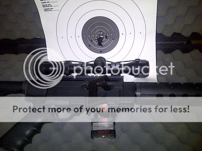

Finished the bolt mod, took me about 30 minutes taking my time, wasnt hard at all, I was worried about nothing! Had to do it twice and take a tiny bit more out the second time I ground the part, works awesome now!
And yes, I figured he was mistaken, he was just letting me know because he didnt want to see me get into popo with a CO.
Thanks to Youtube for the video on how to do the bolt mod, thanks to the manual (I finally read it) for the tear down instructions and Utah for the tip on this mod!

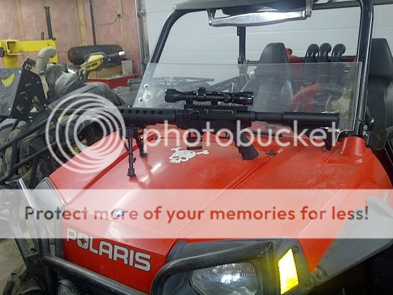

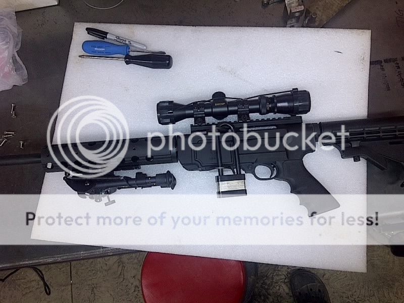

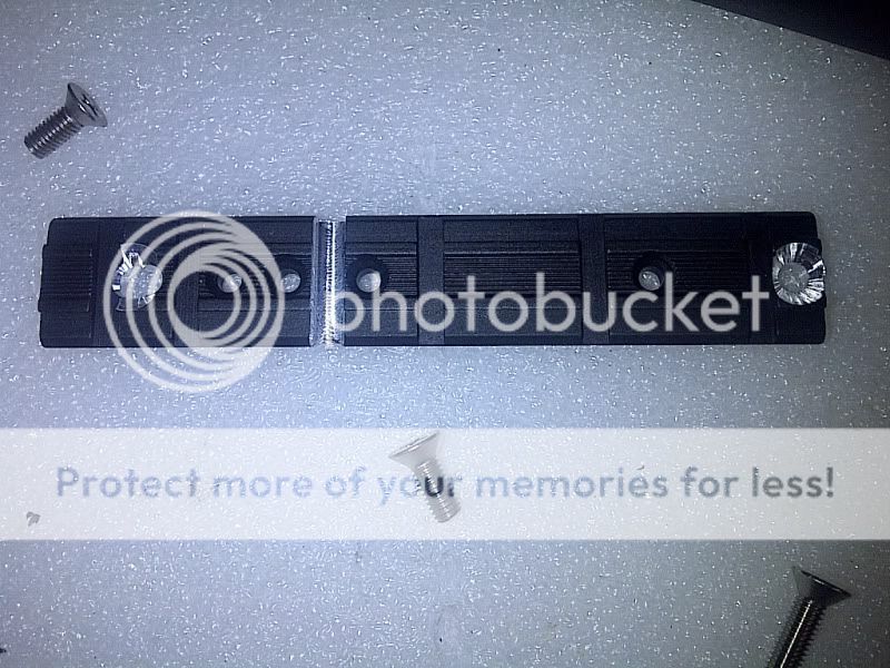

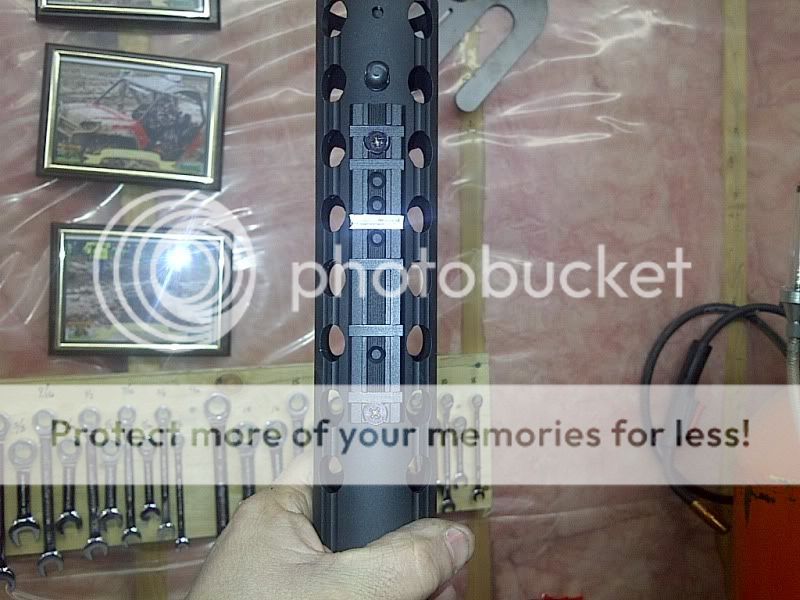

I added a bottom rail, it needed some custom machining to make it work, luckily I have a Bridgeport mill in the man cave :)
I had to open up one of the slots for the bolt used to clamp the bi-pod to the rail, and had to open up 2 of the mounting holes as well as move one about 0.09" and re-countersink the holes.....
Take off the sling/tripod thingy (let the barrel free float), mount the rails flush with handguard, that way the bipod mounts to the end.
