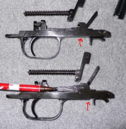

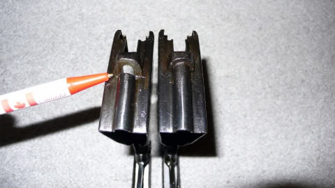

Evidence suggests that the refurbishment may have been a far more regular process. The Soviet Sneaks for example (Soviet sks45's imported to the US from Albania and import stamped as "M56 Made in China ") exhibit signs of heavy rebuild which would have taken place prior to 1960 when the Albania split with the USSR and turned to China as their primary source of economic and military aid.
I have three Soviet Sneaks in my collection-- one all original 1958, and two all matching, heavy refurbs.
https://forums.gunboards.com/showth...t-Sneak-or-SKS-45-56-Peculiar-mix-of-features
https://forums.gunboards.com/showth...Soviet-Sneak-Any-clues-to-date-of-manufacture
https://forums.gunboards.com/showth...hing-Soviet-SKS-45-56-K-suffix-Laminate-stock
nice information here - going to take a look at my 1950r Russian - and take photo's of all markings (if any)
Often there will be no overt stampings to identify refurbishment. But Updated designs, or differences in serial fonts are a good indication of replacement parts.
Type1 trigger on top vs Type2 trigger on bottom:
type1 magazine left vs. type2 magazine right:
If your 1950 carbine has the type2 bolt and carrier design with a free floating firing pin, it would be an indication of refurbishment update.
