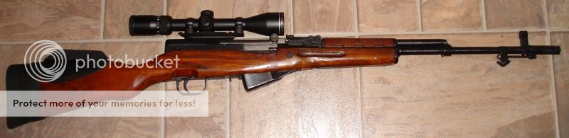

I am using all steel weaver lever-lok's, med. height.
They are perfect for this gun. Note that I positioned the mount lower than usual, but had to grind the bottom back end of the choate mount before installing, and can just squeak in the bolt when cleaning.
I'm fine at close range with sks iron sights out to 50-75 yds, or my peep sights on the Izhevsk.
However, when shooting at 100 - 200 yds, the Vortex at 12x is awesome.

I like the way you setup the Choate.
What kind of groups are you getting @ 100yds with surplus and hunting ammo with this setup on a benchrest? Any pics?

Thanks, here's what it looks like today
With surplus, accuracy is anywhere from 2-4", all from the same crate.
there is lots of variation in the loads and so I'll see tight clusters with the flyers. I wouldn't make any bets on sks accuracy when shooting surplus, sometimes, you get one that's way out of spec.

Hunting ammo gets me somewhere around 5 shots 1.25" at 100 yds.

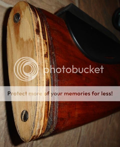

Other features:
medium walmart (usa) winchester limbsaver recoil pad, plus 1/2" plywood spacer, to get length of pull around 13.5"
Plus, a Accu-riser check rest. It gets my eye to about the right height. Quality of this part is ok.
Rest of the story: trigger job, side eject receiver mod (squared off rear corner of port), choate muzzle brake, and of course, a recoil buffer to protect my scope.
If you do the side eject port mod and use a nice scope, I suggest putting some protective material, i.e. duct tape, etc, on the bottom of the objective, because the odd casing will hit the scope.

Well done LarryG!
Accuracy wise is as good as it gets and you solved the cheekweld and LOP very nice on a budget.
I have a nice Russian I will keep stock, but will do up someday a Type 56 similar to that with ejection port mod. I also use that same slip-on buttpad for shooting any short butt guns I own. :)
