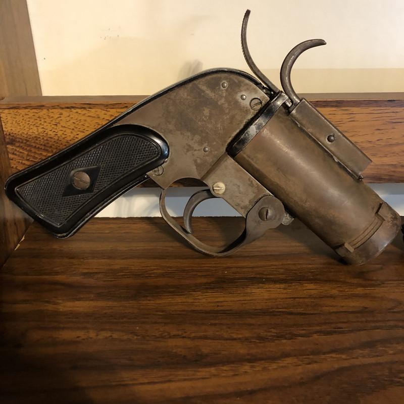

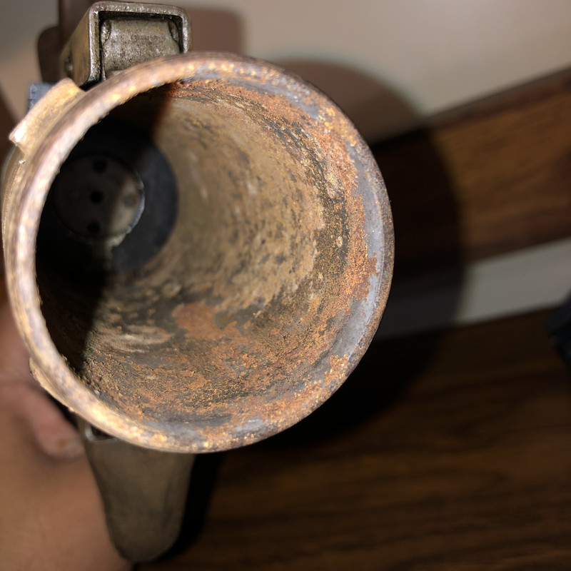

Folks, I’ve got an M-8 I’ve been meaning to tidy up for years now, and never get around to it. Anybody got some resources on how to clean it up? It’s got a little surface rust on the outside, and the bore is particularly rough. I’m guessing the old flares used corrosive components. I’m not looking for a perfect restoration, just enough to make it look better on display.
Thanks!

Internally on the barrel I would use a pad of fine steel wool on a suitable short rod, oil it well and spin it with a hand drill. If the result shows pitting you will need the services of a gunsmith or perhaps a talented machinist to fine bore and polish it to a perfect chrome like finish.
Externally, lots of elbow grease with extra fine steel wool (###xx), well oiled, will remove the rust slowly without damage although if any of the rust is severe it will leave pitting. Do not use any power tools unless you are trying to buff out light pitting and then you must be very cautious, it's very easy to cause noticeable damage. Final polish with Flitz metal polish for a gloss finish suitable for blueing although this would likely be a finer finish than as manufactured.

It appears that über duper light steel wool and oil is the way to go. As for oil, any preferences to type/brand?
While the bore does need the most love, I’m mostly just interested in stopping any further deterioration. I won’t be firing it of course, it’ll just be on display, so the exterior is my greatest concern.
In fact, I suppose with a 40mm bore, it would draw a furled eyebrow from Mr. Trudeau’s OIC, so it’s not likely to be on display where anyone but me can view it anyway. Nevertheless, it would be nice to pretty it up a bit.

Evaporust works great on Youtube videos and goes well with Nutella, but its chemical action is strong enough that IMHO it is unsuitable for firearms. (Bear with me, I have an Arts degree not a Chemistry degree.) Evaporust's action neutralized the oxides, and turns them black, or they fall off. There is magic happening under the surface that looks dramatic when applied to a shovel or cast iron milk separator. But, I don't trust the migration to leave enough strength in gun parts.
There are two alternatives used in the hot rod and vehicle restoration hobby. First is a chemical soak in molasses. But it is incredibly sticky stuff that is guaranteed to seep out of any pin holes or tears. A friend of mine built a kiddy pool sized bath to soak his rusted and seized BREN Gun Carrier tracks. The tub leaked and he had an inch of frozen molasses all over his shop floor! The second is reverse electrolysis that uses 12v DC current to "pop" oxides off steel parts. There is no chemical change.
Take gun apart and boil all rusty parts in distilled water for an hour or more. Card off the new black oxide with denim. Repeat if needed. Heavily oil when done. This will preserve any existing finish.

The out side, I don't think you want it shinny, the bore, that will take some work, a small round wire brush, sandpaper on a large dowel , or maybe a 3M pad on a stick, , end turned down to fit in a drill
Cut a slot in the outer end to slide the pads or sand / emery paper into.
If you had a brakehone, that would work great
