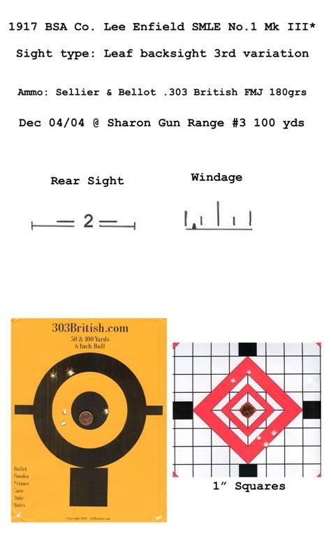

~Angel~ uses nothing but S&B .303 British for all of her Enfield shooting, including her No.4(T)'s.
She owns a beautiful all original BSA Co.(1917) No.1 MkIII* (all matching numbers), including the rear sight. It even has the spring loaded Flanders muzzle mud flap mounted on it. She took it out to the range and was reasonably happy with her first "zeroing" go round at 100 yards. Here's the range report she put in her "data book" for this particular gun.
Note: Some details omitted for privacy. ;)
(Click Pic To Enlarge)
