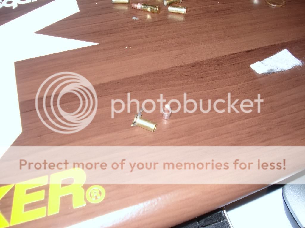

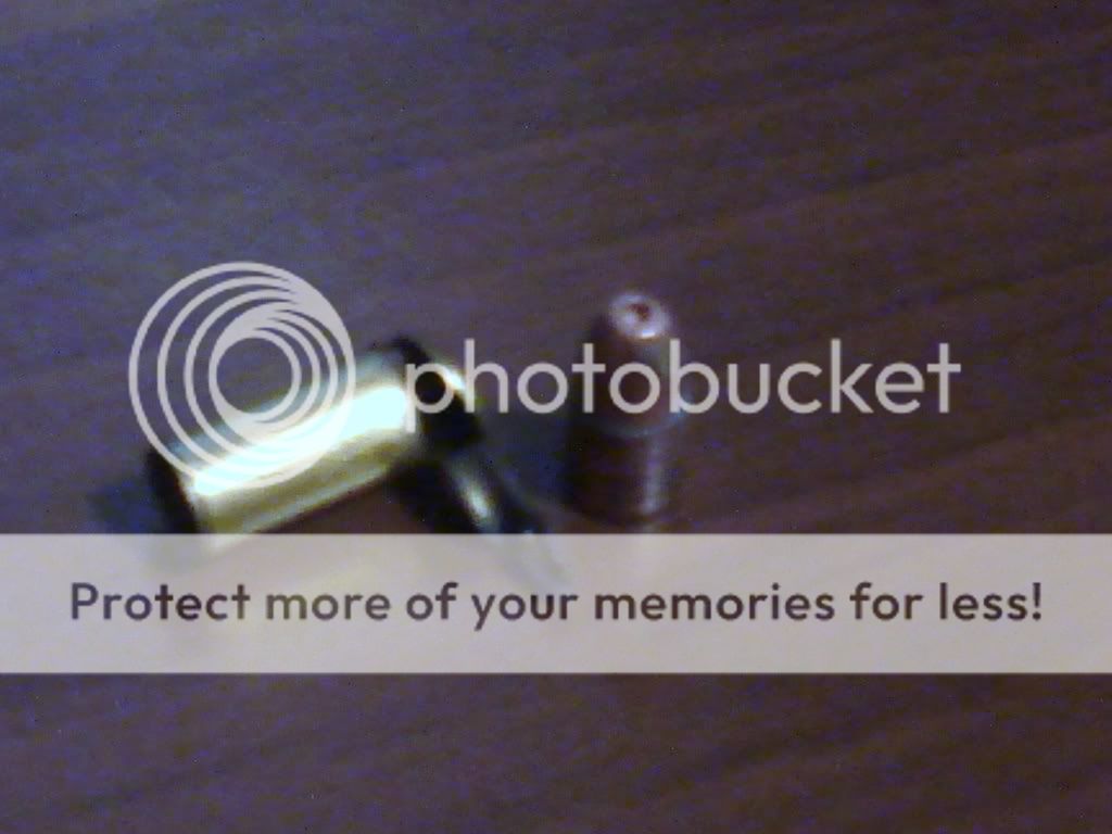

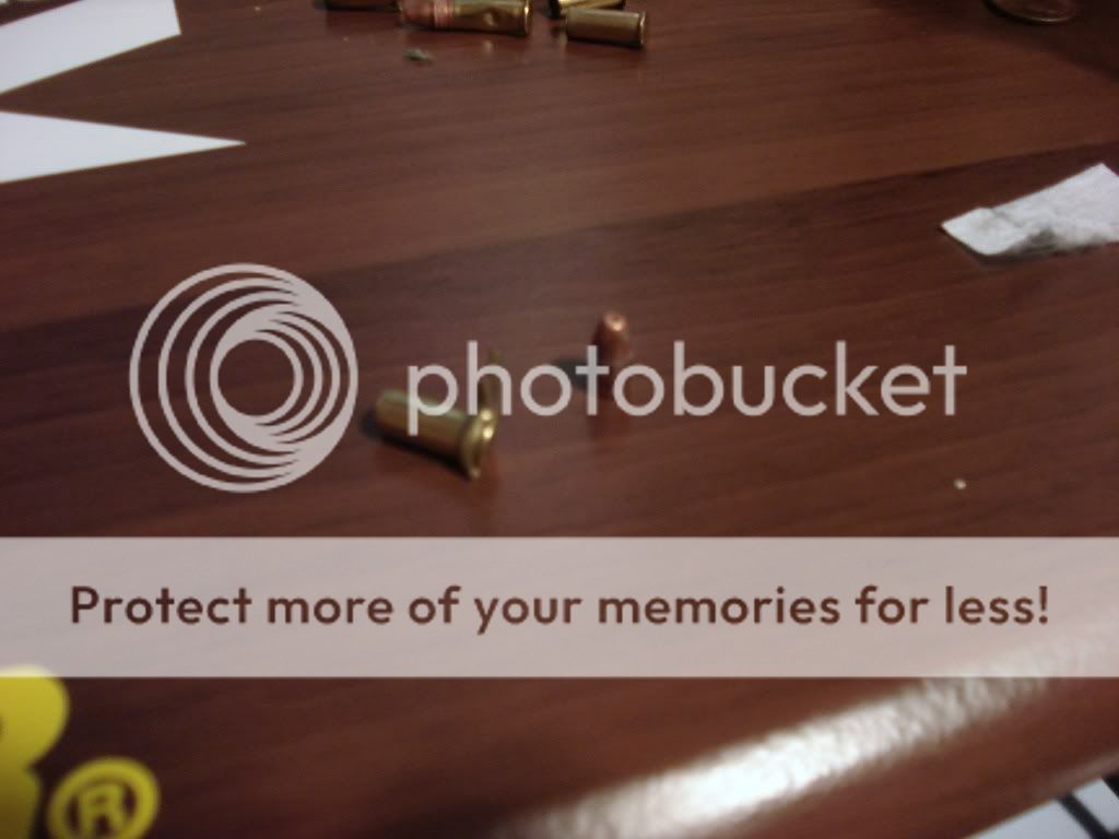

my extractor blew up around 250 rounds in. I sent it back, then waited my month and a half. When I took it out to the range for a second test, about 50 rounds in, it blew a case in half, and jammed it into my rifle...
I was firing during the first incident and my friend from the dutch forces was firing during the second. So I dont think this was an operator error.
