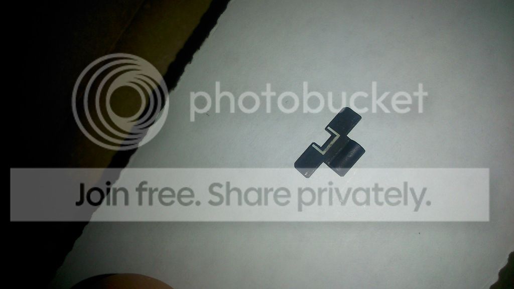

Anyone got a picture of what a rear blade looks like, removed? I am thinking the underside notches might be different. One for the spring and one for the screw.
Here you go:
The blade should be reversible (except a white outline version like I have shown will lose that feature). There are no notches on the blade; the click adjustment is found on the head of the screw going across the sight, a hole to accept a tiny spring and plunger.
I wouldn't call it *easy* to change the blade. First off, the screw is a sacrificial part, so get a new one first (nine greenback dollars at Brownells I recall). Remove by shearing the head at the end of its travel, then pliers on the shaft and run out. You need to clean all threads so it doesn't bind and break during your install! Run blade to the middle of the screw, fit in sight body with plunger and spring, and install fiddly tiny spanner nut. Stake screw over nut with a centre punch.
