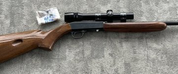

I have a browning SA22 and while the iron sights are good I was wondering how much more accurate I would be with a scope. My distance eyesight is not great and I hate the idea of mounting a scope to such a slim rifle. Can anyone recommend a scope that would have a minimal footprint but also increase functionality. Ideally the cost would be far less than the gun itself. Shots would be up to 100 yards at the range but in the field 30 yards or less.

I am Age 71 , so I can empathize about distance vision going to hell - I am to the point that if it does not have a scope, I can not use it. My SA-22 has got a 4X "Baby Browning" scope - I think that was made by Redfield, back whenever. The mounts are made by Talley, but the base unit is stamped with "Browning" name - the rings and base came in a "Talley" box. To mount it to the rifle, I had to remove the rear sight from the barrel - the two threaded holes on the barrel allow the cantilevered base to attach to the barrel, but the base sits over the receiver. The very rear of that base has like a "set screw" that keeps the rear end from flopping up/down. The screw tip sits on the rifle receiver, but does not engage into it by a threaded hole. It allows continued use of the SA-22 take-down feature, so I am told - I have never taken that rifle down.

I put a scope on it once only to discover that it lost it's nimble receiver carry "feature".
I took the scope off for amentioned reason and put a small red dot on it. Won't put a scope back on that rifle. To me it's not meant to have one!
With the red dot, there's enough room left for wrapping your hand around the receiver for carry and the take down length isn't affected as much as with a scope.
In addition, I don't use the original Browning cantilever base but the Weaver 60A. It's shorter than the OEM Browning. Hence it also helps to keep take down length short.
Here's the setup. A smaller reflex sight would make the sight foot print even nicer...

Thanks for the suggestions! Maybe a rear peep might be the way to go if I can't track down a nice 3/4 scope with the cantilever mount. The red dot or reflex option might be good also.
