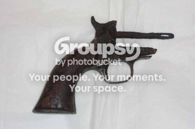

I'm selling a number of handguns for an old family friend. He mentioned he had a SAA that he might want to move on to a better home. I was horrified to find this.
From three feet away, it looks salvageable, but when you get closer, I dunno...
Butchered screws, zero original finish, and a patina that screams "buried in the garden for a couple of years". It was a first-gen blackpowder frame with what appears to be a four-digit serial (although the three line patent dates on the frame would place it later than that). Someone (probably brunching with Hitler about now) appears to have made an effort to render it inoperable via welding...
The "ejector rod" isn't...
Everywhere there are hints of either the last few tiny traces of nickle finish or "overspray" from welding...
The passenger side looks pretty good...
...if you don't mind the honkin' gap 'twixt the frame and the grip frame.
The bore looks like a railroad tunnel, and has been ground down at the muzzle, but only on one side...
The patent info is still legible atop the barrel, but just...
This is a sad, sad thing. It's like meeting a lady of advanced years who once was a respected member of the community, and now she's working as a coke whore.
The Blue Book tells me that a pistol of this vintage is worth something like $5000.00 in 10% condition, but I truly don't believe she's even rating that high. There's a lot of trainwreck in this old girl. With the welding and scratches, I don't even know that the frame is salvageable.
What think you folks? I know that restoration is a question of money, and that a guy could throw enough money at this pistol to make her beautiful again, but how much money could we be talking about here? What could be done about the welding?
Can she be saved?

get it apart so you can better determine the extent of the damage.
At the very least you could have a dandy display piece.
the more I look at those pictures the more it appears that the damage was a failed attempt to fix.
On the left side the screw heads are #####ed from someone trying to muscle them out with the wrong screwdriver.Then they ran a file across to take the burrs down.
Don't be surprised if the welding was the same kind of poor try at a fix.
Sloppy cylinder pin?weld it tight...one just never knows.
I've seen some pretty stupid #### when it comes to firearms.I spent 2 hours one time talking an old neighbor out of welding washers to the barrel of an Anschutz .222 to protect the front sight...
Well if you can get the trigger gard and back strap off then drill out the Actions trigger and bolt and hammer screws you might be able to rebuild that Action.
A good gunsmith could do it but to get it looking decent again with that much damage i dont know.

I hope the "welding" is just solder, if so it should be easy enough to carefully reheat and let it run off

It can be saved. Lots of money in, not as much out. Problem is, it can be made pretty again, but never original.

Well guys fear not the gun will be restored. :)
I bought it and intend to fixer up and post pics of the gun here once its all nice as i can get it.
Im not getting to crazy with getting the patent dates re rolled, i knida like the worn look just needs the gouges smoothed out and the nicks dealt with Screws replaced threads recut ect.
I will salvage that orignal barrel and i have the proper Orignal Ejector houseing to go back on the old girl, i have a few in my parts collection.
Once its all cleaned up and re tightened up i bet she shoots 2 inch groups or less at 25 yds again :D

Dang, man - any "after" pictures?
I will look. the gun turned out Ok nothing fantastic tho.
It shot great and as far as i know is still doing good as a bush packer.
There ya go... the gun needed a new barrel and cylinder. other wise it would not have been a shooter.
Well done, Dingus. You're doing righteous work! That poor old lady suffered at the hands of some heathen wanker, but you've restored her dignity and given her a reason to live.
You're like the Salvation Army of guns. The Salvation Armorer?
I'll forward the pix to the fellow who owner her before you. He'll be tickled to see her back in trim.
