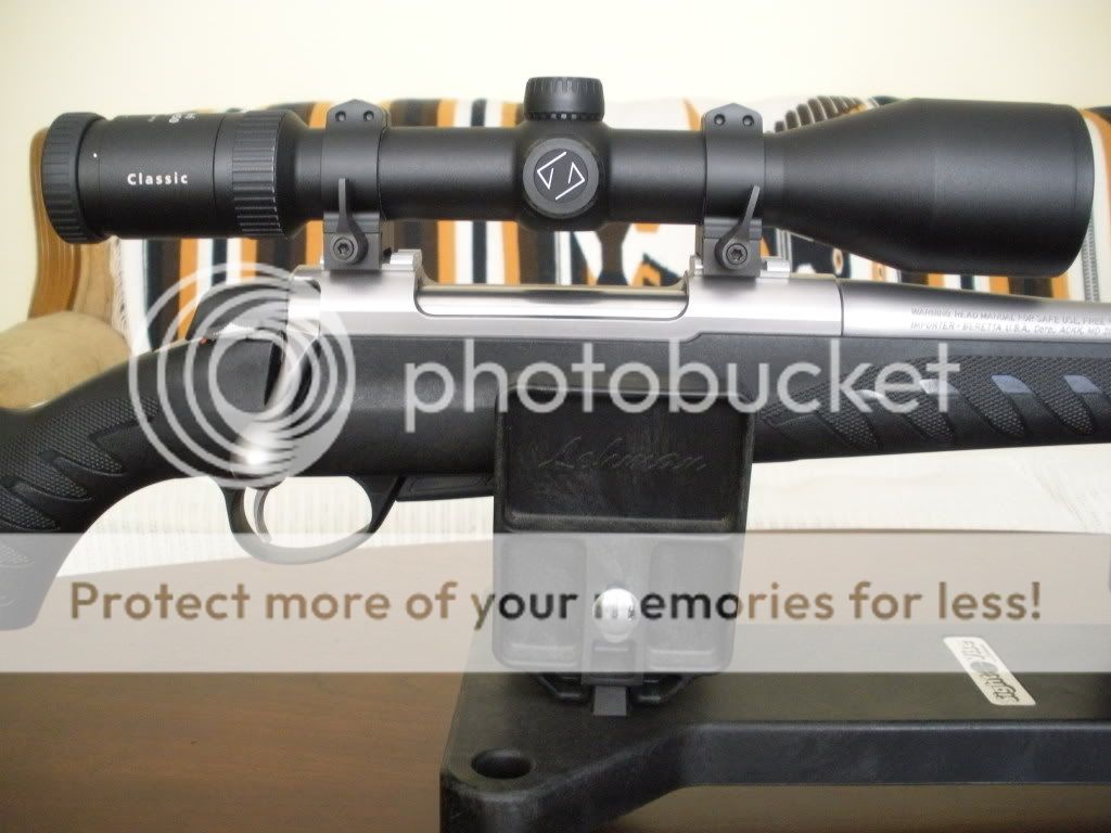

My Sako 75 with Leupold VX2 3-9X40. Its similar to your setup...
