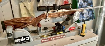

Thank you, South Pender - the rifle is home with me now - some details that you mentioned. Barrel scroll indeed does say CAL. 223 Rem. 8". It is a laminate stock - decently heavy weight barrel that appears to be stainless steel. My postal scale says the unit weighs 8 pounds 14.8 ounces - bolt and empty magazine installed; Leupold 30 mm rings installed, but no scope on it yet. About the only 30 mm body scopes on hand are fixed power SWFA - so this one will likely get the 16X or the 20X.
A "neat-to-me" feature - it has a single "set trigger" - so push the single trigger forward and hear a "click" - now becomes extremely light pull to fire - is much like the "single set" trigger on the CZ 527 Carbine that is here.
Sounds like you have the 85 Varmint Laminate Stainless. Nice acquisition! Enjoy!

I could not find where is says so on the rifle, but the box end flap sticker by Stoeger says it is "85 VARMINT SS Lam 223 RM W/ST" I do not have any loaded .223 Rem on hand - so I just inserted empty unsized cases into that magazine - it accepts 6 empty cases easily - will not accept a 7th one in there. I do not yet own any .224" bullets heavier than 55 grain - so that will be my first go at it - 55 grain V-Max. Previous owner was getting superb accuracy with 75 grain Hornady bullets - at the moment, I do not own anything that heavy - but the one turn in 8" twist would seems to like a heavier bullet, I think.
