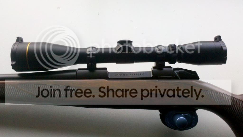

Here's a couple pictures for reference. The first is Optiloks with xtra-low rings and the second is Leupold ring mounts in low - both are 40mm scopes.
I don't know why anyone would buy a "lightweight" rifle and put those heavy cumbersome looking optilocks on it.

No problems with Leupold medium rings. (edit) Looking at one of the poster's image above I may have dropped some 'lows' on it - can't remember, but there's a very small gap at the front. I remember reading someone had trouble with the short mag cartridges hitting the scope but I've never had a 7mm-08 shell give me troubles.
