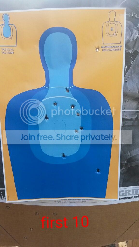

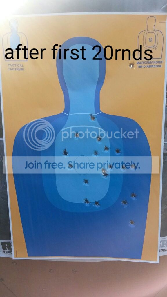

25yrds, umc 115 9mm, with my crappy skills lol.. More info to come
Shot appx 110rnds total.. Sights are like combat sights, cover what you wanna hit. Gun doesnt feel slick in the hands like I thought it might.. FNS40L felt very slick in comparison.
Did not feel the need to regrip the pistol like I did with the m&P9 and 40. That or it wasnt enough to notice. Also recoil did not feel as snappy as it did with m&p9. Very manageable.
Pistol felt sturdy in hands throughout. No mag issues, FTE or feed. But only 110rnds.

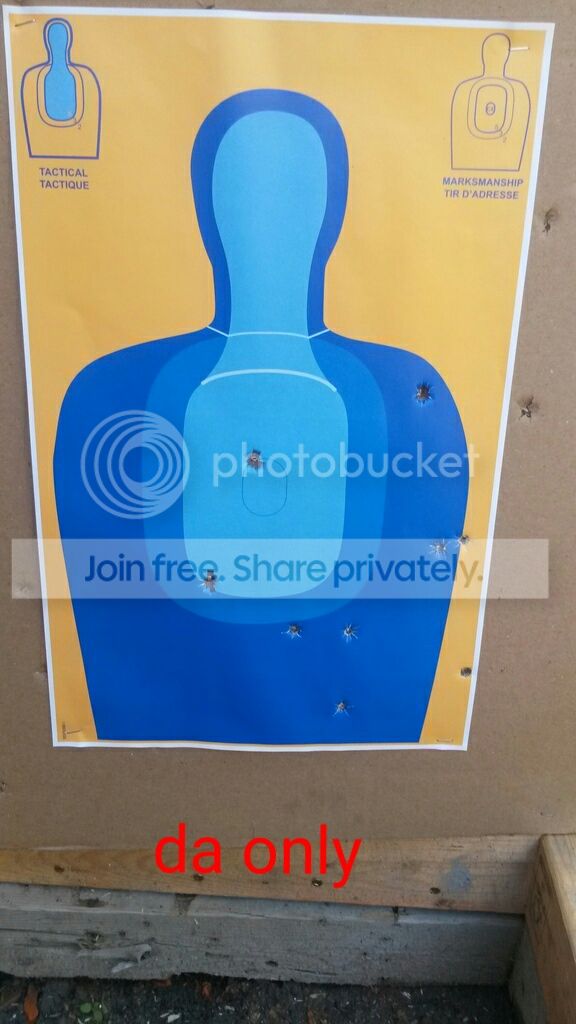

Range trip number 2.. Pretty cool morning around 9/10*C with chilly breeze. Another 200rnds fired no issues even after changing hammer spring and cutting in down some. DA trigger pull is much lighter now. Actually moves the hammer at appx 7lbs and SA now sits at 4.5-5lbs appx.
Also fired 50rnds of 124gr AE ammo which shot much lower.. I also used some CZ75 mags and all worked without issue, they just stick out and look out of place.. But not an issue for me.

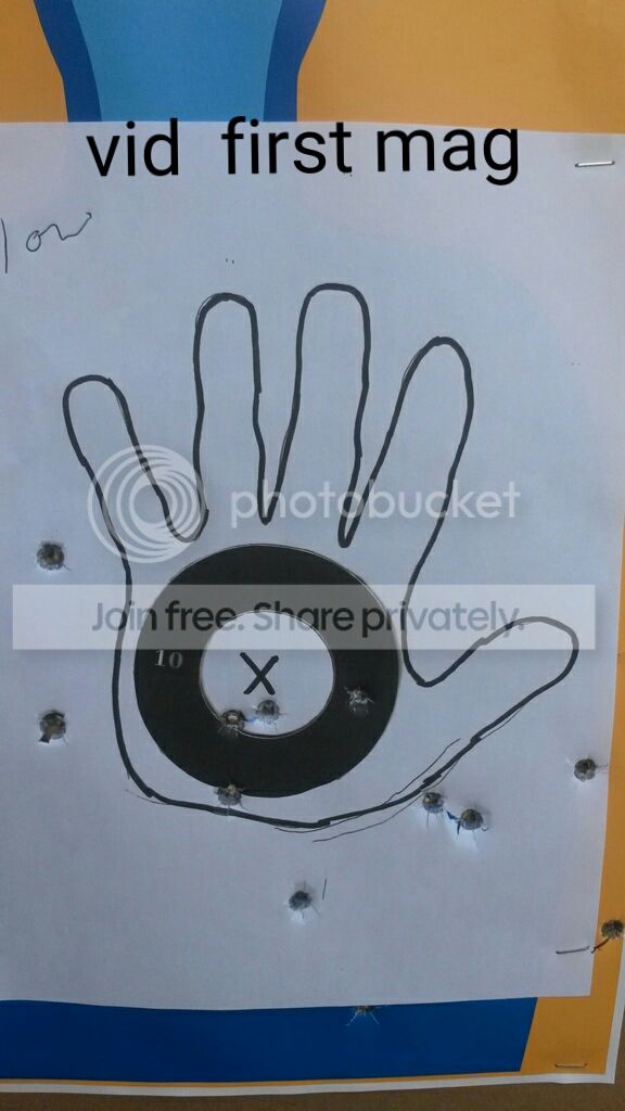

Was out this morning again testing it and also the sr9 that I just got used. Another 100 rnds down range and 50 from the sr9. Learned I dislike the sr9 sights, mainly cause its not what Im used to, but otherwise no issue.
If the B6c, I learned that if I baby the slide action with cz mags it will sometimes hang up, but 100% reliable while firing.
Above is the first mag shot in B6c and best Ive ever done. I'll measure some of the circle to give a better idea for the target size.
Also, I have replaced the hammer spring with a 13lbs wolf spring for S&W revolver hammer spring before this range trip. Did not have to cut or mod anything to make it work.
