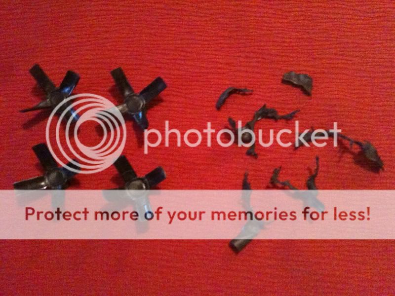

One thing I had read about but never really saw proof of was letting the barrel cool between shots. I learned why. Here's the result.
Some say read the sabot, others say it doesn't mean s**t, well I've discovered it's definitely a clue to why you missed your target. I was fortunate and had a freshly mowed and solitary range outing that afternoon. These were wasy to find and I picked up a few and put them in my pocket figuring I might write something like this. The sabots on the left were when the barrel was cool, either the first shot of the day or loooong intervals between shots. These are Hornady sabots rated for the 10MLII and it was an overcast day about 20C. The ones on the right are after I followed up immediately with another shot or waited even just a couple minutes. These shots didn't even hit the paper. I'm a little ashamed to say, I have no idea where they went. The intact ones on the left were well over 2-3 MOA but I wasn't there to really squeeze the accuracy out of it. And besides, that's still under minute-of-deer...
