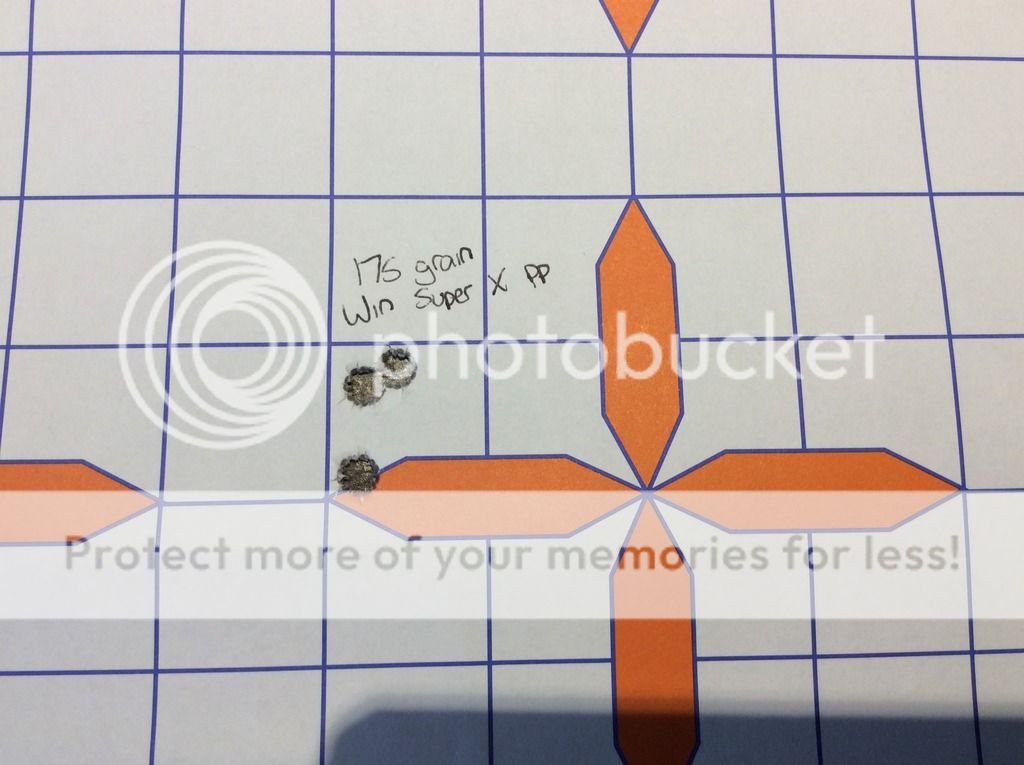

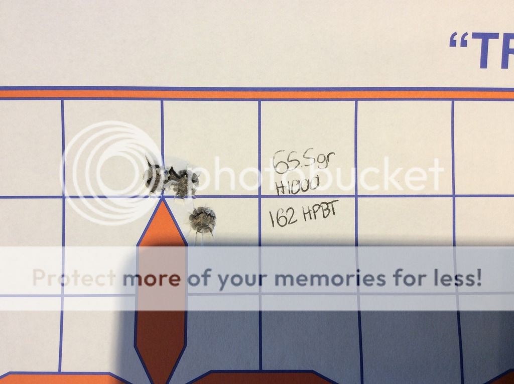

I am taking it out today if the weather cooperates. Going to run a bit of factory ammo and then possibly some hand loads I put together. Overall it seems not too bad. Adjusted the trigger as light as I could get it. Re-torqued everything. Tossed on a 4-12x50 vortex. I just wanted to try one of these low budget options and play with the 7mm....

For the price i think its a great rifle. I am going to the range tomorrow to test and chrony some more handloads. I am going to keep an eye out for sales so i can grab a 300 win mag and 22-250 just because.
