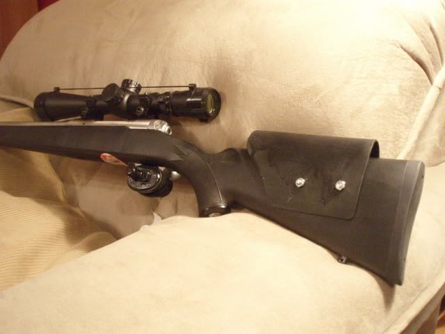

I have a 12FVSS in .223 and I simply love it. I admit that the stock is sub-par but I get a long fine with it for now. I've heard of others having success with stiffening the stock with some pretty cheap DIY methods, you could search a round for some instructions. Also, you won't feel bad messing around with the stock during DIY projects haha, I made myself a cheek rest and didn't hesitate to start drilling holes.
