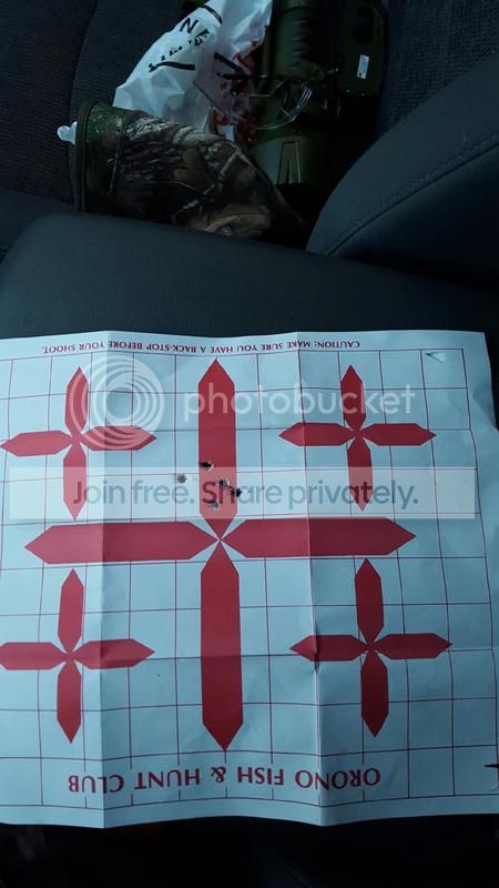

I picked up a Savage 11 Trophy hunter recently in 243 with the 9.25 twist. I bought a box of 58gr V-max pills and already have lots of Varget and 4350 on the shelf but I haven't started loading yet. I bought a few boxes of Winchester 80gr JSP varmint and predator and this stuff shoots MOA in my rifle so I went back for 6 more boxes. I'll start load development in the spring now lol
Here's a 5 shot group shot with 80gr Winchesters at 150M. this is using the cheap package scope that came with the gun.

^lol....we're on the same track. Bought a box of the same stuff to get myself on paper...good to hear it shoots well. Maybe I should try it before getting any deeper into components/powder! ;)
Thanks for this. I am sold now. I am hoping to shoot heavier bullets if the twist allows it.
