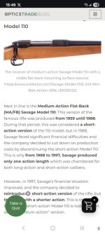

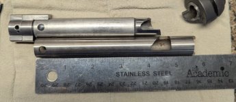

Savage did make a medium length 110 action back in the day, maybe for one of those? - danHey all, I was sold this as a replacement for a short action right hand Stevens 200 .View attachment 1085936
Definitely not correct.
It also is not long enough to be for an Axis.
So too long for a Short action, not long enough for a long action, and a little short for Axis.
Edge? Maybe?
This pic is with my axis.
It's looks like it's an old, short action.Hey all, I was sold this as a replacement for a short action right hand Stevens 200 .
Edge? Maybe?
