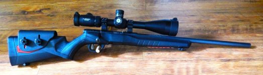

OK, I tried twitching the opening on the bottom of the scope rings and they did indeed slide on the mounting studs. I admit that was a little tense because they didn't seem designed for that treatment. They did however tighten down nicely. Having gotten that far I mounted the scope to see clearances from the barrel and it clears by a hair or two, no contact. The lens cap doesn't slip in the space. Since the rig wasn't level off I decided to pack it in for the evening and try for a proper install over the weekend.
Thank You gentlemen for your advice. Attached is what the rig looks like.
PS
The optic is 4-16 x 44mm, tube size 30mm Outside dianeter of the bell is 52.23mm

Tried it, it worked, thank you. The rings are Burris zee rings, medium. As it stands I assume the studs are 0 moa, thanks for the heads up on the 0moa base. I figure a move to 20 moa base once I've figured out the adjustments possible with this mil scope. There is paralax adjustment but I will need to once again look up miminum focus distance. I had been using a 270 for "long" range games but it was getting too expensive and for ranges over 200m I had to skip over the border to a friendly family farm. So I've decided to move back to 22, where I started.
