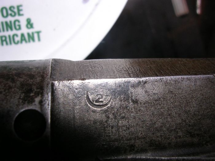

The two circles near the front of the body are, I think, just Maltby refurb stamps. I'm having trouble making out the screw holes at the rear locking recess area.

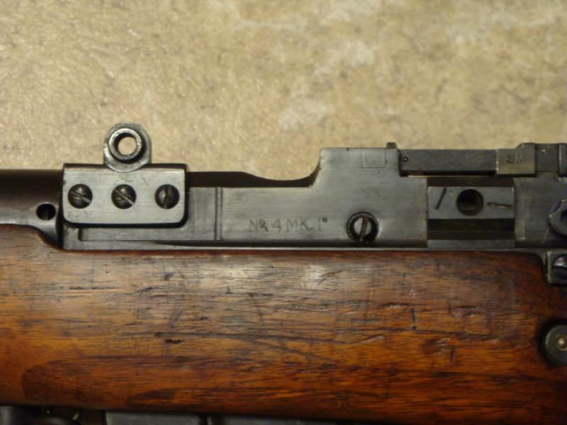

BTW this is a picture of a No 4Mk1(T) you can see where the screws for the mount would be.
Yes, what you see in the picture of the front of the reciever is an inspection mark. The picture doesn't capture the repair I am trying to show. And yes i see looking closer, the No4T mounts are in a different location. Looks like this may be one to return to sender.
