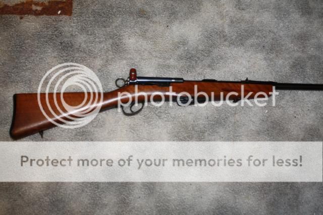

Schmidt Rubin 30-30 Conversion 1960s?
I've just acquired on in almost new like cond, it does have a very tight
Chamber, also yes it does have the sleeved chamber
Gent I got it from was shooting it, was said to shoot well
He was shooting regular 170 and 150 gr.loads
My plans were to load 125 gr sierra spitzers in it
And load intermediate loadings . Also would use some cast
Loads using a lee 150 gr round nose.bullet, I've seen quite a few of these kicking
About but never in this gd of cond, I own a globco #4 enfield and performs flawlessly
This rifle is certainly beefy enough to house 3030 pressures , looking at the savage
340 with one locking lug and comparing the massive 2 lug lock on this Schmidt
I cannot see any reason they are unsafeunsafe. The only thing is the magazine

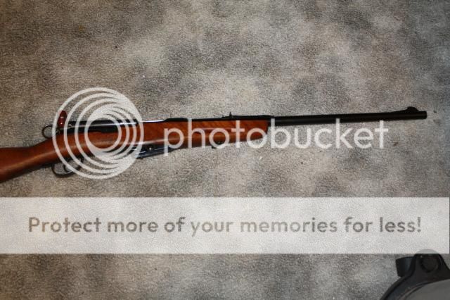

I'm looking forward to.shoot this one, it's in near new cond
Bluing is perfect, it to.is a carbine length , was drilled on top. For.2 bases
Bore is like.brand new, I find the bolt very nice, the trigger for surplus
Gun of its age is definitely an added bonus, I will be deer hunting
And cast bullet loads for range use, I've always liked the 3030
In a bolt action and single shot to fool around wit spizters

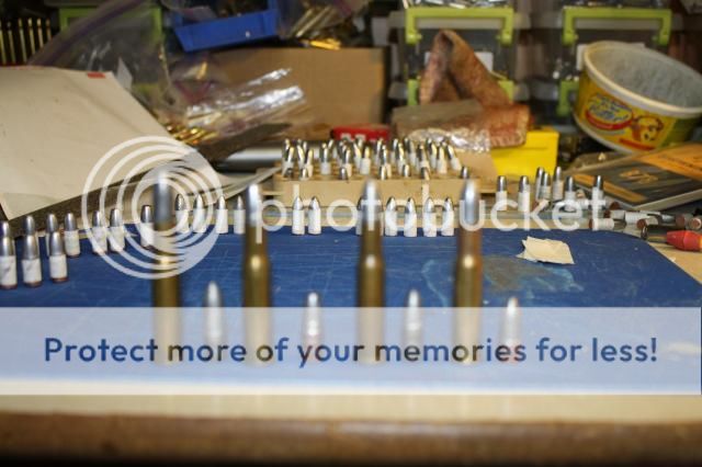

I've been reading this thread with great interest. I'm old enough to remember buying milsurps for less than $10 ea at different outlets back when all you needed to buy a rifle was the money! I bought lots and shot the hell out of them, with all manner of ammunition. Most were in their original chamberings but a few were conversions. Never had one that didn't do what it was designed to do.......shoot! Back on point, I have one of these as well. Haven't shot it yet, but I surely will. I was in the loading room just now and made up some dummy rounds to verify some of the comments here.
Here's what I found out about my particular rifle. Chamber is sleeved, and the barrel is 19.25". So, carbine length. No marks to speak of on the wood and the metal is very nice as well. There was some minor pitting caused by poor storage but some transmission fluid and elbow grease got rid of almost all of that.
Now, for the interesting part. I had 4 different .30 cal. cast boolits sized at .3095" Here are the four dummy rounds.
Sorry about the lack of focus, the camera focused on the other stuff on the bench.
From left to right: #311334 sized at .3095" and measured .3000" just ahead of the driving bands.
Next is a 311041 sized at .3095" and measured .2905" just ahead of the bands. The smallest of the four.
Next is a 311413, sized at .3095" and measured .2995" ahead of the bands.
Lastly is number unknown, sized at .3095" and measured .3065" ahead of the bands, the largest of the four. I loaded them in the magazine and cycled the action and all four chambered with no issue other than the last round hit the top of the chamber before chambering. So, four different boolits all sized at .3095" and different groove diameters and all chambered with zero problems.
Your comments are invited.
Mike
