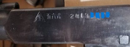

L - Here's the SN on my FT, on the Left Side of the Receiver. Note the faint " 29 " on the bottom left of the pic. Not at all what you describe on yours. Maybe someone can tell you what's up with yours? ( Last 4 digits blocked off )

On my SKS, the /26\ and Chinese characters, are located on the left side of the receiver in front of the serial number.
My serial number has a 8 preceding the serial number which indicates that the manufactured year was 1963 ( I understood that you add this number to 1955+8=1963)
If I’m wrong I am sure I will be corrected.
The stamps on the stock indicates an inspection verification by an individual inspector/factory.

I’m going to put up a couple of pictures of the rifles numbers
As you can see my rifle numbers look very different from what you fellas have posted
That first number is M210296. There are no other numbers on that side of the rifle or the other side .
Not sure what the M stands for, but could the numbers be a date code? February 21, 1996?

Here’s a link to another SKS forum, explained a little bit what the codes mean. It’s a M21 model SKS, specifically built to export to the US.
https://www.sksboards.com/smf/index.php?topic=25055.0
The marking
"M21 0296" (or M210296) stamped on a Chinese SKS receiver is considered a "plain code" or factory code used by the Chinese to denote a specific, but currently unidentified, place of manufacture.
Unlike SKS rifles from the main Jianshe Arsenal (Factory 26), which used numerical codes enclosed in a /26\ symbol and could often be dated by their serial numbers, the "M21" series of markings are less clearly documented.

  • Identification: The specific arsenal represented by the "M21" code has not been definitively identified by collectors and researchers.
  • Dating: These "plain code" rifles generally lack the specific dating information found in the serial numbers of the more common arsenal-stamped rifles. Dating them usually requires examining the specific features of the rifle, such as the barrel lug style, the type of bolt carrier, and other component details, as production methods and features changed over time.

The other forum from the link I added, says that series was manufactured in 70’s
