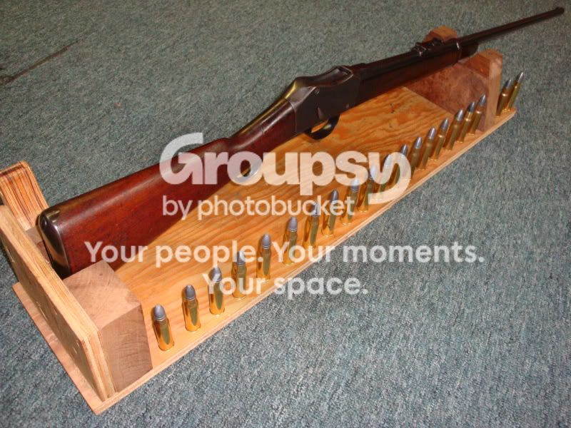

In my Martini Henry I use the same bullets as I use in my .45-70, the Lee .459 hollow base meant for the Springfield. I have examined recovered bullets, and they fill the rifling completely. Accuracy is okay, but could be better. Maybe a larger bullet would be better, but my point is, using black powder will bump up even a considerably undersize bullet to fill the bore. No need to force oversize slugs down a barrel that is, in many cases, 150+ year old iron.
