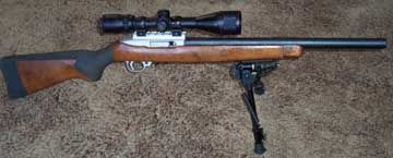

Big JD-From the hills said:
With that range you want AO for sure. Here is my 10/22 with a bushnell banner 4-12X40AO
