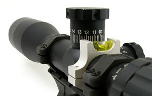

Do you bring that little level to the range with you? If not get a scope mounted level. If you dial for drop make sure that your level is set to the tracking and not the reticle. If you hold over set it to the reticle. They may not be the same.

When out shooting how do you know if your scope is level? Unless you have a wide flat forend and a level on your rest you won't know.
It's surprising how out of level you hold your rifle when shooting. This is where a scope mounted level comes in handy.

Invest in a scope level. If you shoot out close to where your caliber goes transonic you will see huge improvements in group size.
Also I wouldnt bet that your bench is level. Or your bipod holds your rifle level.

Without a scope level you will cant your rifle while shooting. Take your little level and prove it to yourself.
You don't need the scope level to the rifle or bolt race ways or scope rail or etc. It can be twisted 45 degrees for all that matters, as long as you have a scope mounted level that is lined up to the vertical up and down of your scope adjustments and vertical axis of your reticle. This way as long as the scope mounted level has the bubble between the lines you are not canting.

I went through this process last night. First I leveled the rifle, then leveled the scope, then installed the bubble on the scope.
It's tricky though, I find whenever I look through the scope at the reticle I can never quite figure out if it actually looks level or not and I assume that it is due to parallax. My basement just isn't long enough I guess.
After installing your optics, hang a weighted string or plumb bob some 30 feet away. Line up your vertical crosshair on the string then install a scope mounted level. Verify nothing has shifted and now you can ensure your crosshairs are level when your scope level is.
