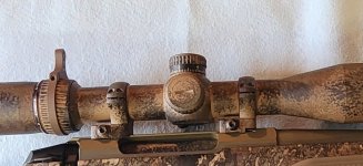

I really like my sako mounts with opti-lock rings. They are rock solid, don't look as bulky as some pic mounts. Although, the pic mounts can add massive amounts of adjustment if your looking to touch something at a great distance.Mount.jpg

I really like my sako mounts with opti-lock rings. They are rock solid, don't look as bulky as some pic mounts. Although, the pic mounts can add massive amounts of adjustment if your looking to touch something at a great distance.View attachment 922641
