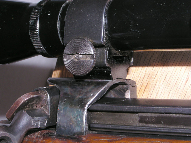

Thought long and hard about the best way to scope it. The front ring is round, the rear flat.
Digging in my box of Weaver bases I came up with a #45 and #48. The 45 countour was almost perfect so I put a piece of fine emery, abarasive up on the front ring and countoured the base to the ring. The 45 was filed flat on the bottom to fit the rear ring.
To get it right a long tube scope was mounted in 2 rings, the rings clamped to the bases, the bases set in place. The scope reticle was set at the center of it's range. With the rifle in a cleaning rest, 2 drops of gorilla glue was put on each base and a bore sighter installed. The rig was moved until it was close to centered left to right.
Let the glue dry and recheck the bore sighter.
If all is good, now you can drill and tap the rings and complete installation.
I used a Weaver J2.5 with a 6X Litscherts converter as it mounts low and has a long tube.
You can see the "308/280 Ross "being extracted.
You may have opted for steel Grand Slam steel bases or Warne ,but the aluminum ones will likely hold.

The cross lock bases give you room to load. When combined very low rings and a 3/4" or 7/8" tube scope give the best cheek weld.
With exception of the G&H mount they either block the loading port or look like suitcase handles.
I suppose optimum would be the "no base" Talleys, milled to be as low as possible. i.e. the style they make for the Browning X Bolt.
Changed my mind.
Removed rear ring male dovetail and filed ring flat
Went thru boxes and more boxes of bases and rings.
In Leupold turn ins, found M96 Mauser for front and unknown but low rear.
Added some old Redfield 1" rings and a Leupold VX III 6.5-20x40 that JUST clears the rear sight.
