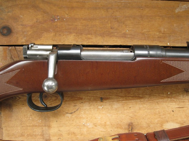

I recently bought a Swedish mauser m38 in 6.5x55. It's being shipped but I haven't received it yet. It's a husqvarna 1943 which has the bent bolt handle from the factory. I believe the only modification to the gun is the sporter stock. It is not drilled and tapped for a scope or diopters.
Is it possible to mount a scope on this rifle without further modification to the bolt handle? I was thinking of a 2-7x33 mm type scope. If its a big job I'll use it with open sights only.
If your eyes are still good, just use the irons sights. They are plenty good enough for hunting out to 300yards. If for persission then a scope may be handy.. Don't think you will have to modify the bolt handle any more depending on the size of the lense of the scope and the eye relief on it.
Here's a pic.
I'll likely use the irons, but I like to know my options.
I have an almost identical rifle... a Husky built in 1942. You would have to use high rings or get the bolt handle modified, and the safety will have to be changed too.
Very high or see through rings will be needed to clear the bolt handle. If the scope is high enough, the safety will clear. Cheek weld may become a jaw weld.
The receiver will have to be drilled and tapped.
For a lower mount, in addition to drilling and tapping, the bolt handle will have to be altered, and a low scope safety fitted.
i think your only issue will be the safety. that bolt looks like its bent far enough down. but a higher mount and tall rings will correct that.
