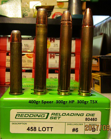

Many ways to the load the 458 Lott since there's a wide selection of 45 caliber bullets available. Current hunting load is the 300gr TSX at 2500 fps MV. Or a 500gr bullet at 1850 fps MV using 458 WM brass and a compressed charge of Re19 to keep the bullet from getting knocked back into the case, and to keep the bullet seated out to minimize the distance to engage the rifling.
I see no need to load my 458 Lott any faster. Even for use on Yeti.
