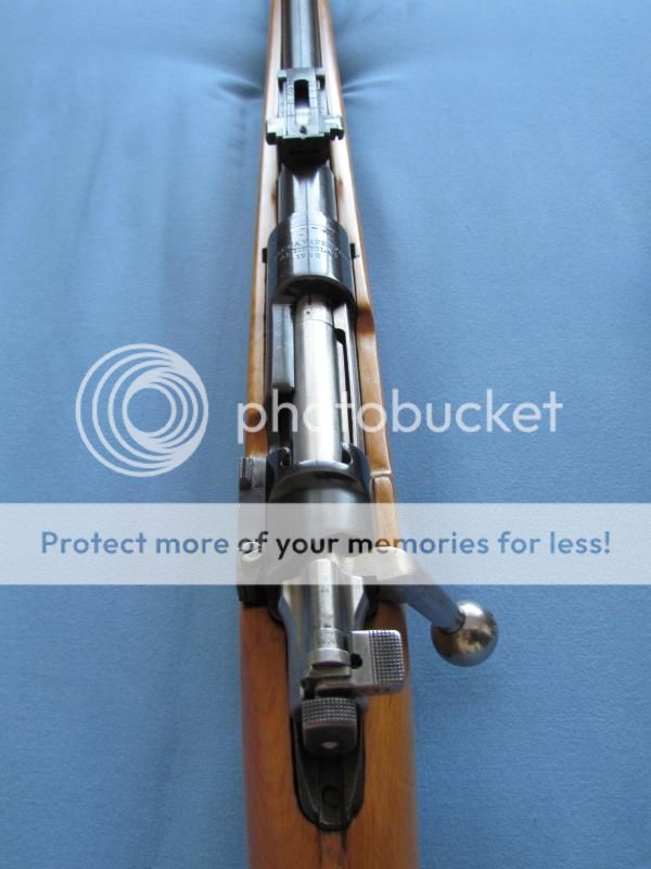

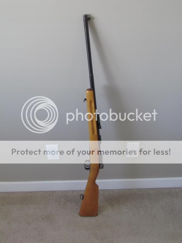

So, here it's: the base for my build - 1942 Husqvarna Mauser model M38 in 6.5x55 that was sporterized many moons ago and spent the last 14 years sitting in the safe of its owner near Kelowna.
Nice and clean receiver that wasn't drilled, smooth bolt operation and capability of feeding via stripper clips are all desirable features in my humble opinion.
I'm planning to install a single weaver base at the rear of the receiver and use the XS high weaver base backup ghost ring sight.
After cutting down and installing the new barrel I'll decide exactly what kind of front sight should I go with. I have some ideas already. I'm also planning to go with the XS scout scope rail.
