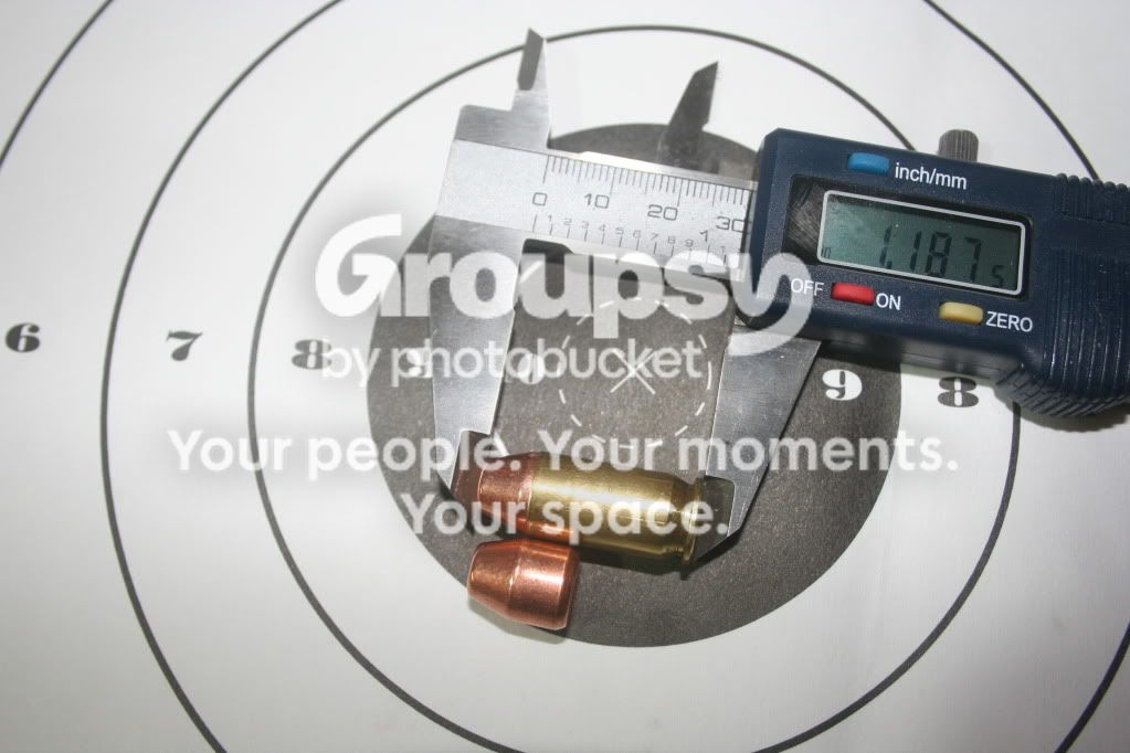

I've been searching this and another forum for info on what a good recipe would be for 200 gr FMJ .45 ACP ammo for my Norinco 1911A1 and I'm wondering if anyone sees anything wrong with 1.177-1.195 OAL? Powder 4.6-5.6 gr of 231. I normally consult the Hogden loading charts for this kind of info but I don't see a listing for FMJ SWC there.

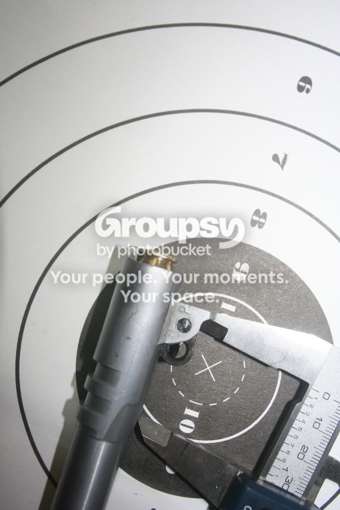

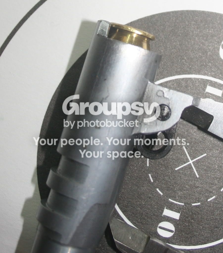

From what everyone said I took a bit of everybody's input and measured the maximum distance from the base of the case to the SHOULDER of the bullet (not the tip). I got a measurement of .95". Checking the OAL at that time I found the following :
Some pics may help explain:
Zoomed
The maximum OAL I found I could get without the case protruding above the headspace is 1.195. The first bullet I seated was at 1.177. Anywhere in this range is ok, I think.
Any input would be appreciated.
