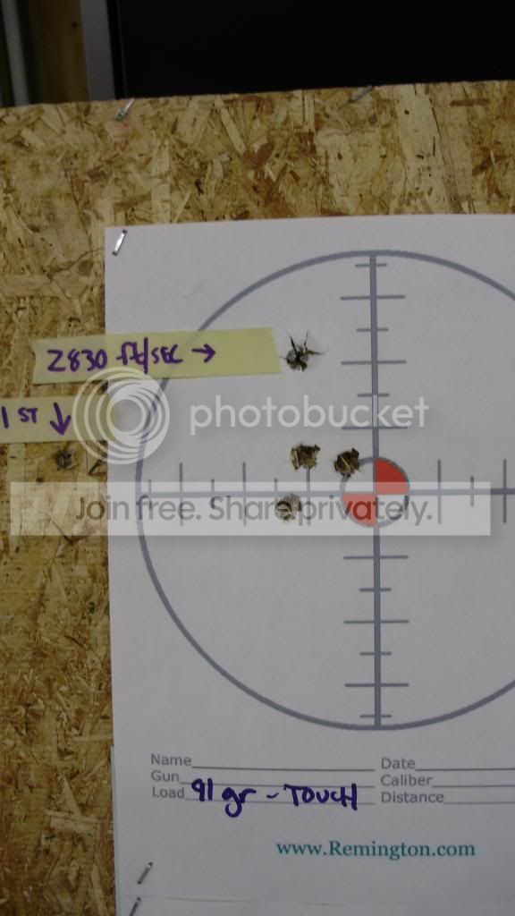

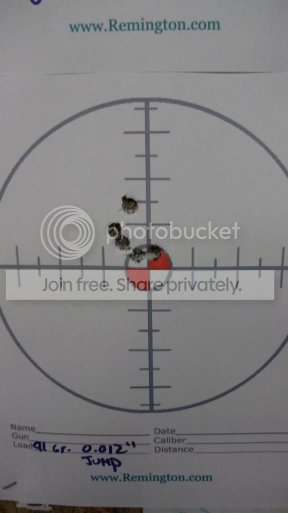

I do my process slightly different also, and depending on rifle/application.
It comes down IMO basically to pressure which vary and are changed with a)seating depth and b) charge weight. The degree to which influence I do not know, I cannot test such variables.
For a rifle with a magazine I ensure the seating depth allows for use of the magazine.Then, do my testing with loads and chose one, haven't had to vary depths yet as accuracy has been adequate.I will however record my OAL with a comparator and I will find the lands just to know what distance I am.
If I am doing one with no restrictions I will go with the manufactures recommendations and then vary my jump or jam after I have optimized my charge weight.If I have no information I will find the lands and do a +/- of 0.005 , 0.010 , 0.015 , 0.020. or whatever number I/you decide to use for increments.
Here is an example above of finding a weight, then varying depth.
So many differences between components and rifles, pick a system you like and are comfortable with and stay consistent, get a comparator for the few $$ they are and I like to use a magic marker to find the lands, works for me, YMMV.
I adjust my dies every time I use them so leaving them for a particular bullet never really bothered me for the few seconds it takes to find your mark or to change for ogive differences.
